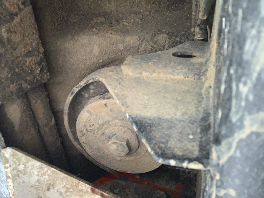

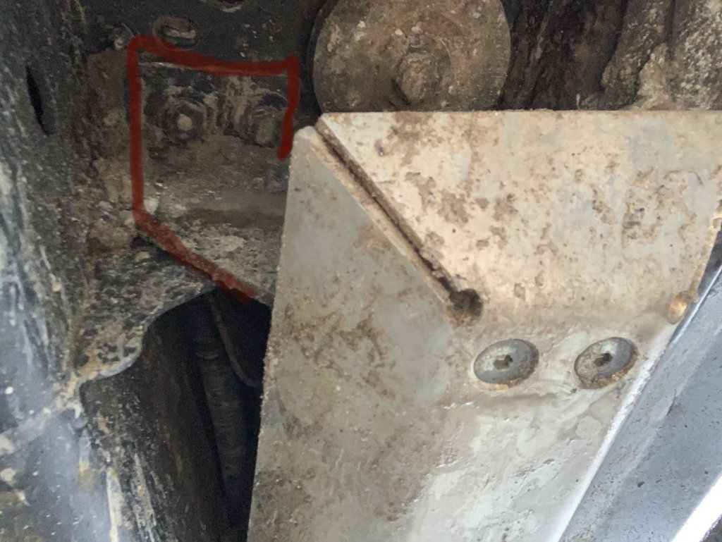

I have all of Asfir’s skids and the air tank one is the most straight-forward from what I remember. You should have two brackets that bolt to the main skid part with supplied flush Allen bolts, then two of the existing air tank bolts are used to secure the skid. My LR4 is at the shop right now but I can look for you on Wednesday or Thursday if you’re still having difficulty. The “instructions” are just CAD drawings and basically useless.
rolledover
Oct 23, 2019
41
30
Fremont, MI
Not very good photos as it was snowing out so couldn’t crawl under, but the first one is the front and second is the back. The rear bracket is hard to see as the skid covers it. You bolt the brackets to the vehicle first, then attach the plate. The front bracket is offset to the inside of the vehicle. You’ve probably figured it out by now, but if you’re still having issues or need any help with the other skids let me know and I can get some better pics once vehicle is in the garage.
