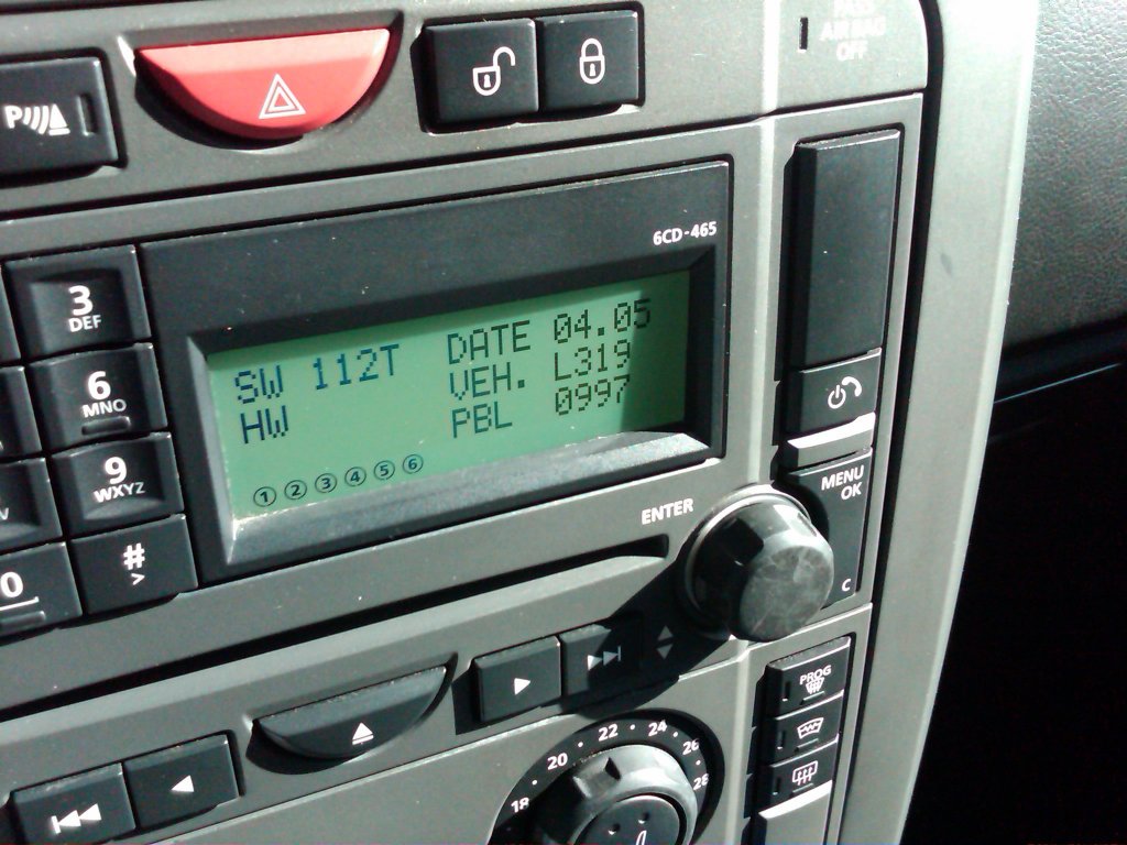

I am assuming that it is a CD that is stuck in your HK 6CD-465 head unit?
If so, about all I can suggest is the Eject Multiple Discs instructions on page 48 of the LR3 Audio System booklet per the attached pdf segment.
  • Ejecting CDs HK 6CD-465.pdf
