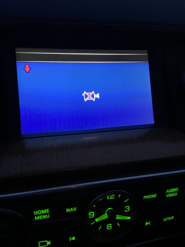

Hey folks,
My backup camera worked fine, and now sporadically shows me a blue screen with red X over camera logo. Has anyone else experienced this? I'm in Canada, where it is currently cold. I've never had an issue with it before in the cold. Wiring harness? Please see attached photo of screen that is displayed when I'm in reverse. Sensors, forward and back, seem to be working fine.
Thank you.

I had this issue (also only when cold) with my car.
The dealer installed camera equalizers on all of my cameras and they have never had an issue since.
My dealer installed:
LR031216
LR031218
LR031219 (Driver mirror camera)
LR031212 (Front left or right)
LR031214 (Front left or right)
These are CAMERA EQ kits. I don't know which specific one is for the backup camera. Has to be 16 or 18. All the others are for the mirror cameras and front cameras (I have the surround view package)
They stated installed per bulletin LTB00430NAS2.
After further reading of my service records, it appears my rear camera was also replaced once upon a time after logging a fault code (B12D-31)
You have an IID tool by chance?
Also attached is a tech bulletin that might be related to your problem. It doesn't seem to have the part numbers that my dealer installed. So I'm not sure if it's helpful or not.
