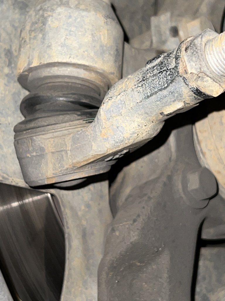

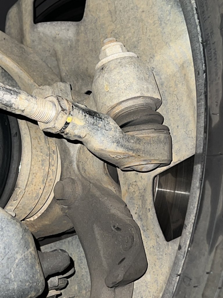

Not sure if these will help much but here’s the right and left side

Jack the fronts up and support with jack stands. Make sure vehicle nice and secure and then sit on ground straddling tire. Grab wheel at 3 & 9 and try to wiggle it back and forth. If you feel any wheel play it is likely the tie rods (inner and/or outer). Now grab tire at 6&12 and repeat. Any play here and you are likely dealing with wheel bearings.

OP says LCAs, links and sway bar mounts (bushings) have been done?
When I did this last I got motion with the 9 &3 grip however The motion I got was just the wheels turning right to left
