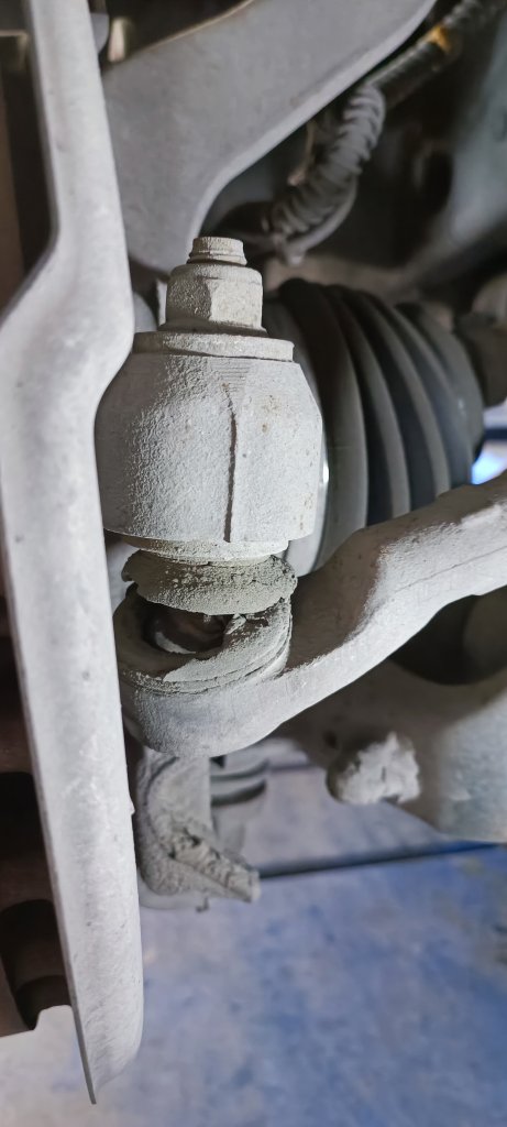

This is a bad tie rod end.

When I did this last I got motion with the 9 &3 grip however The motion I got was just the wheels turning right to left
If there is play there, it will feel different from turning against the steering. Steering turn feels fluid and smooth, like peanut butter (not chunky). If there is play, it feels like you have to move your tire a little bit before you even start working against that peanut butter. It will often have a clunking noise, too, if it's bad enough.
Tie rods are the cheap and easy replacement, but if you haven't done the upper control arms yet, I think it could be that as well.
