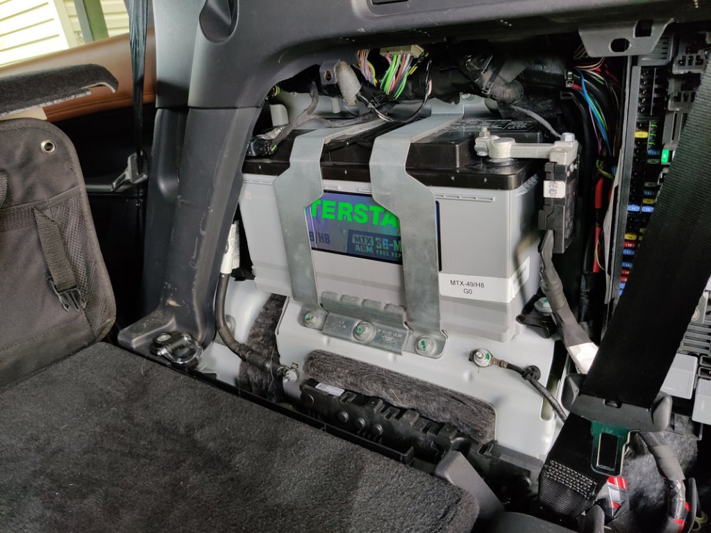

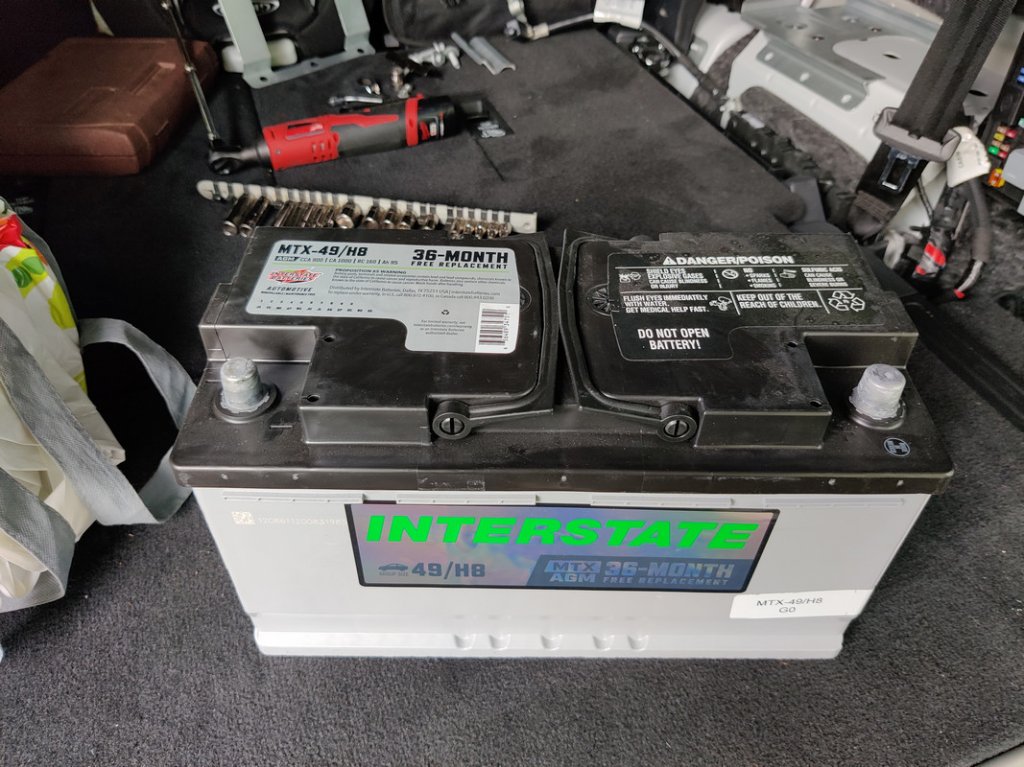

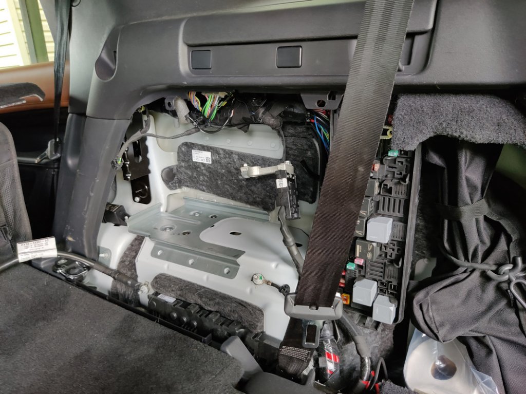

    I just changed my battery 2017 D5 HSE LUX TD6
