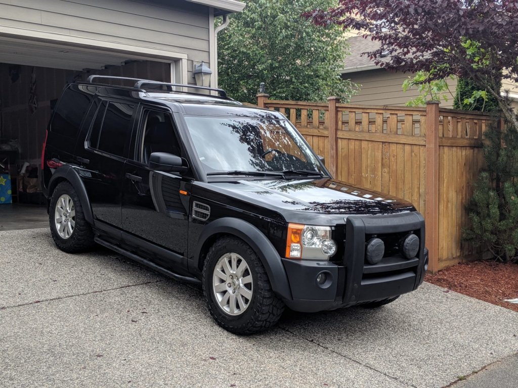

I am an avid detailer. If you'd like some suggestions on products, I can oblige. This pic was just the other day. I'd gone off-roading the weekend prior so gave it a big treatment.

Mighty, mighty clean looking beast!
