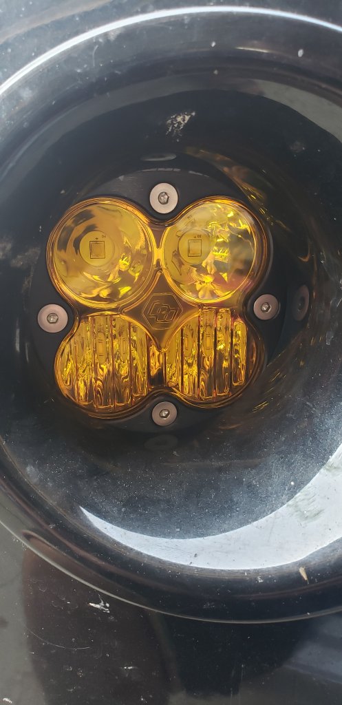

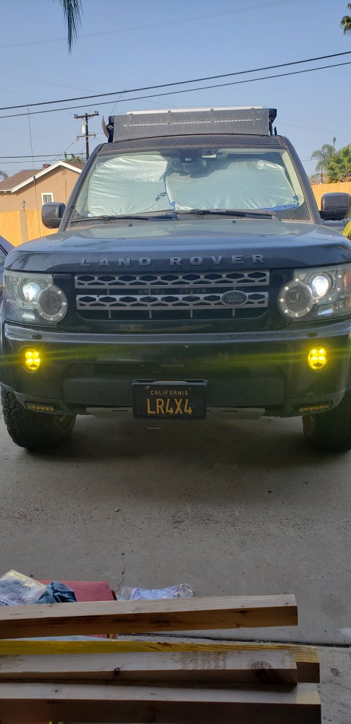

FYI... They turned out way better than expected!! Love them!

Looks great but I have to ask: why yellow? I like yellow for snow and such but I think bright white is better for general off roading?
I'm glad you asked. I roll with a crew that's 10x faster than me, borderline trophy trucks wheeling, overlanding, etc... when flying through the night behind someone's dust trail white lights reflect dust like it does with snow. The yellow fog lights cut through all that especially when it's lower than the visible point of view of the driver. Hence, replacing the fog lights with these.
I have white floods behind the grill and a spot/flood combo FRO light bar up top. So, in the video, you get to see a preview of most of my lights. All of which I run when I'm not behind a cloud of dust.

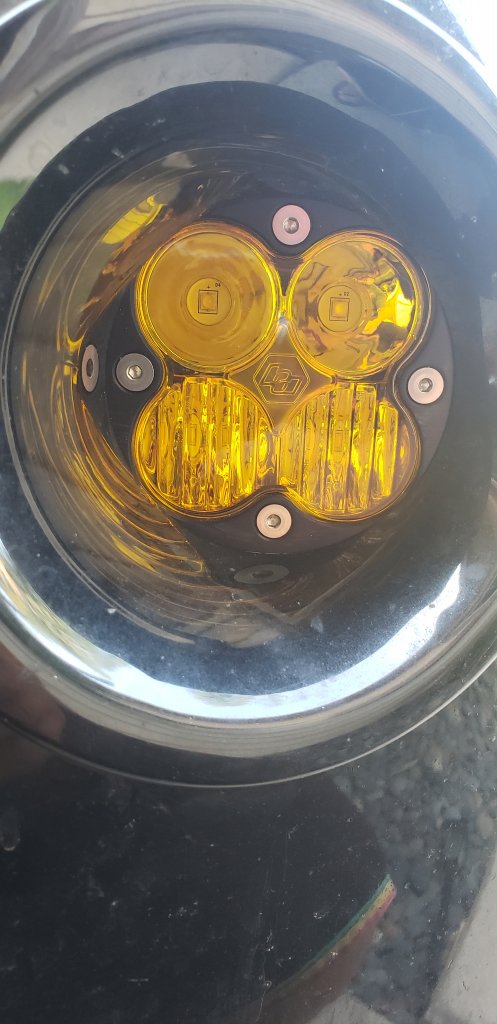

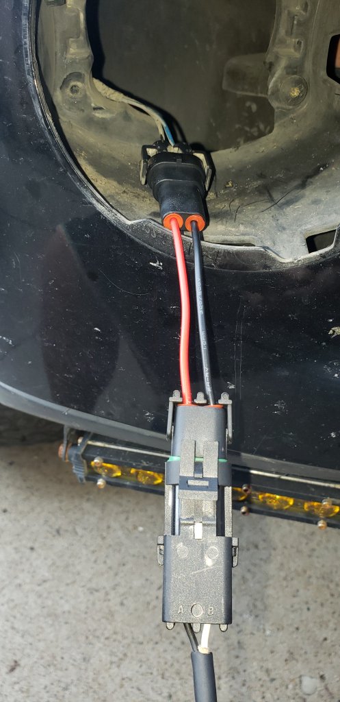

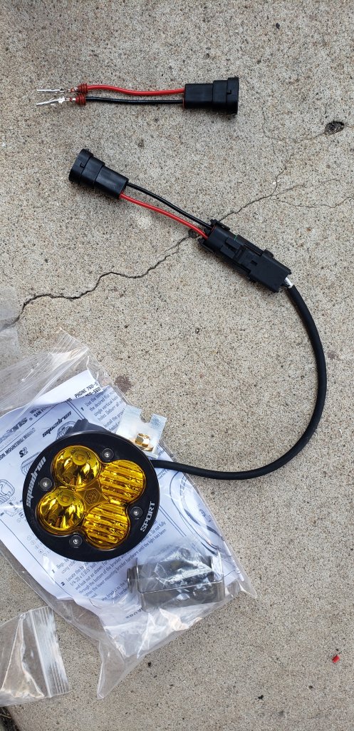

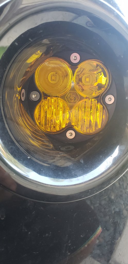

Update: Got them H11 male pigtails crimped with the BD connectors on. I wasn't able to correct the wiring color on the pigtails, but they are wired up correctly.
Here's the wiring with the connectors, notice the H11 black wire is connected to the white wiring for the BD lights.
The factory blue wire connects to the black H11 wire and back to the BD white wire, or factory blue to BD white. Factory black to BD black.
Passenger side sits flush with oem fog light cover.
Same with driver's side.
Welp, they light up with factory fog light button!
Why the sport instead of the pro? Just curious

The sport has less lumens and i could probably get away with using it on the road vs purely off road. It's half the cost of the pros. At least that's what I tell myself.
