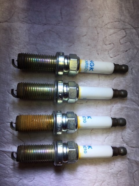

I guess you will never change the oil that way again. Plugs due at 100k miles. Mine were ready at that mileage for renewal. With your miles I would not bother.
One was rusty which was weird (Passenger bank). Also NGK superseded the stock plug with one higher heat range.(now 7c10 instead of 6c10)
good to know. I may push it to 8 years then. Thanks!
