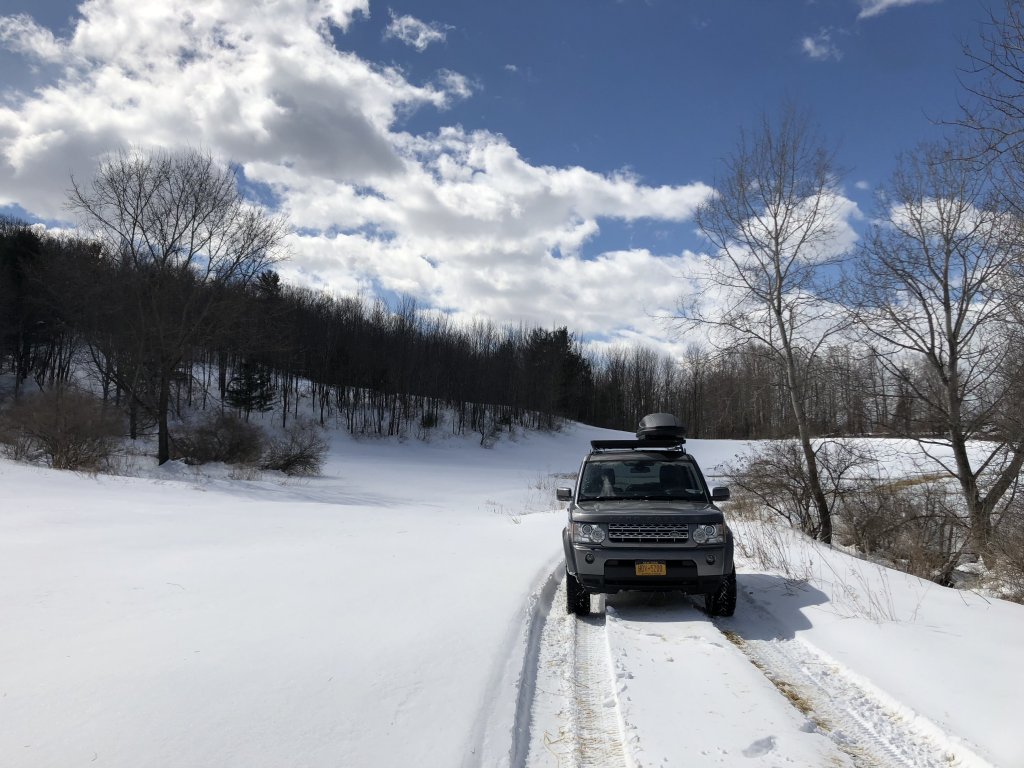

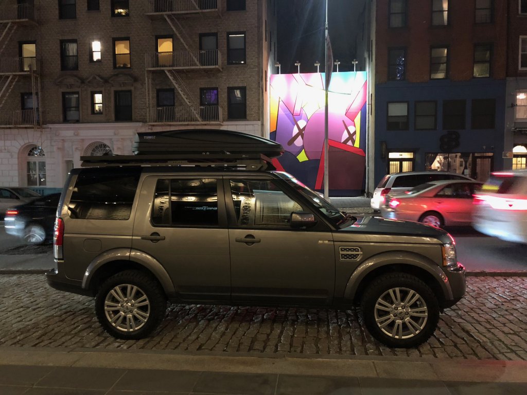

    Here are some pics of my set up. The second pic gives you an idea of what room I have available on the top (the empty space is where our surfboards go).
    What racks do y'all use and do you like them?

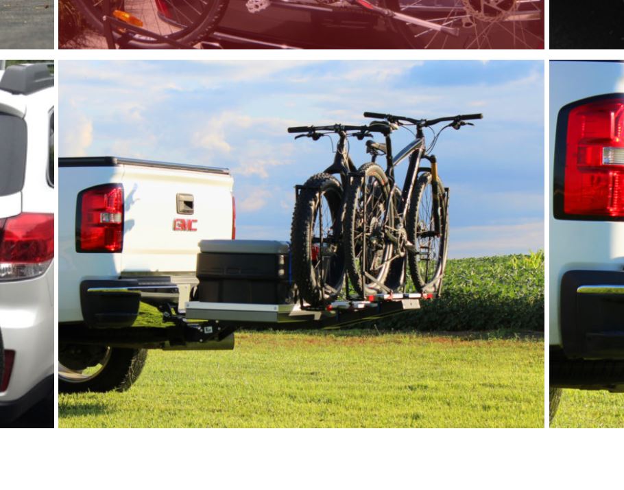

    So that was returned and I went back to researching. I ended up finding a photo of something that I thought would work but wasn't advertised as a 5-bike carrier (see photo). After a phone call to the guys at 1UP (https://www.1up-usa.com/) they confirmed it definitely would work and told me all the parts I would need. Final price was north of $1000 but the modular nature has give me a 2-bike rack, a cargo rack, and the ability to carry 5 bikes when needed.
    The 2-bike rack goes in no problem. If I want to carry all 5 it gets a bit more complicated, but it's really not bad. I insert the cargo carrier and then attach one of the extra attachment points to the rear of the cargo carrier (two bolts). I then need to remove the bike tray (two bolts) from the 2-bike mount and install on the attachment point that I just installed onto the bike tray (again, two bolts). It all takes less than 10 minutes. That was for adding one bike onto the cargo carrier. If you want to add another, just repeat the process.
    Now, for my girls bikes I just stand them all up in the cargo tray and use ratchet tie-downs to hold them in place. I figure I have a little time to figure out a "real" tray solution for them but I know I can just buy more trays and make a mounting plate to affix to the cargo tray.
    In the end it is a pricey solution but it does everything I need as well as stowing neatly and compactly as possible when not in use. I lean the cargo tray against the wall in the corner of the garage and the 2-bike rack fold up and sits on a storage shelf in another corner. Also, it is nicely engineered and solidly built in USA.
