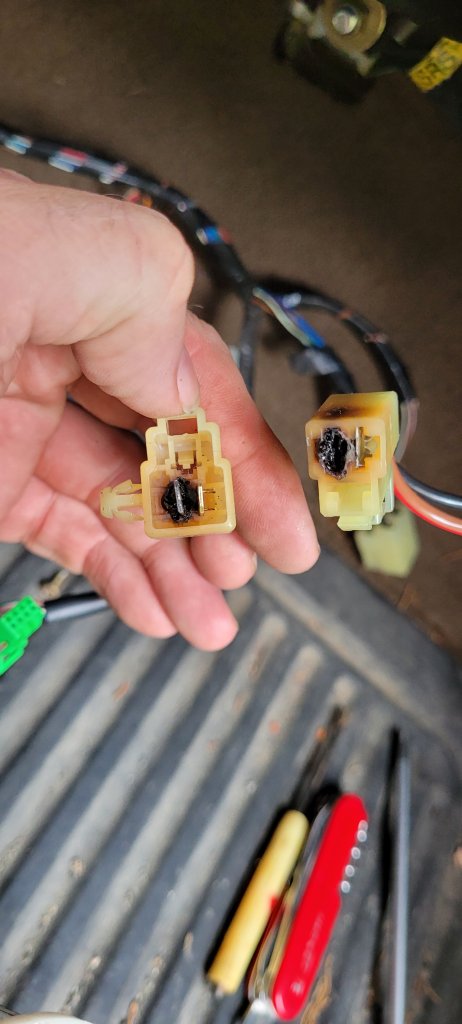

My blower motor stopped turning.
Pulled it and it spins on 12v.
Replaced the resistor and fan still does not spin. Only 1.9 to 2.6 v at the fan harness.
HVAC panel lights. Only gives 21 and 22 errors.
What else is there to look at other than I was sold a bad resistor.

What year/model Discovery? Could be a bad switch, could be corrosion at the fuse block.
I would check corrosion at the fuse block, that is where the fan wire comes from and normally causes this issue. I have made more than one bypass wire for this issue. (fused of course)

Found it..
That isn't pretty at all. Glad you found it.
