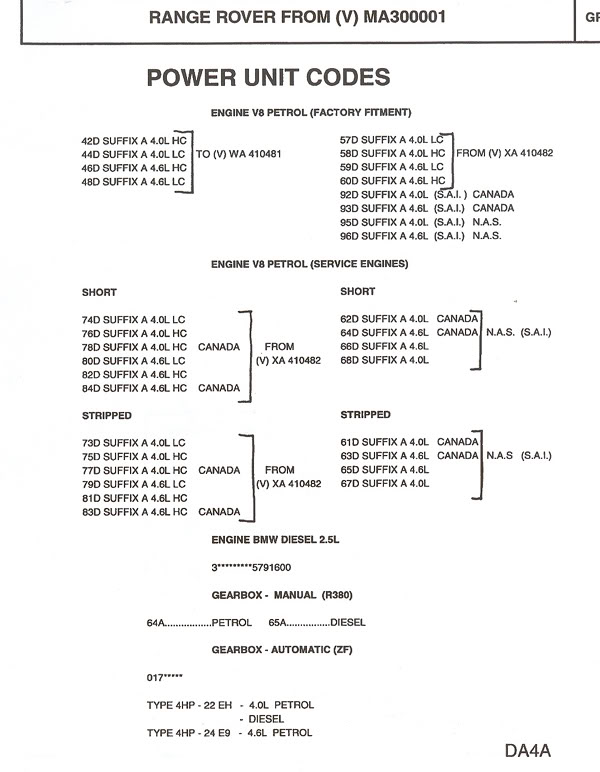

    How can know if engine is 4.0 or 4.6 on the bosh models if is out of car already trying to buy block for my 2003 4.6 disco due to plroblem with sleeves ,thanks

    Sorry late to the party but have LR engine code numbers to identify 4.0 to 4.6 engines. Give this a go old chap. 95 D1 5 spd repowered with a 4.6 w/chip and cam upgrade. Well worth the added torque swap vs the sad LR bored out 3.5 to 3.9 turd. I hope you got that 4.6. PS, do yourself or engine a favor and change out the cam and lifters as OEM is crap they are both shot by 60K miles including the timing chain and sprockets. Go with a true roller chain system vs "el cheapo link type of chain and sprockets. Piper cams comes to mind as the best cam. Summit or others for the Edelbrock true roller timing chain and sprocket set, I recall it also fits a GM V6 engine. I would clean the engine externally the flip upside down then pull rods caps as well mains then inspect (mike journals) with intentions of rolling a new set of mains and rod bearings. Also check the oil pump and rockers including the shafts for wear. A tight engine will be better lubricated with a higher oil pressure and a longer life. ......~~=o&o>......
    [​IMG]

    Mike, what are your 4.6 "stage 2" Hp, Tq and cam specs?
    All 4.0 engines become 4.6 when sold used seems to be the norm.
    Block numbers I posted above are a sure way of identifying a 4.0 vs a 4.6 engine
