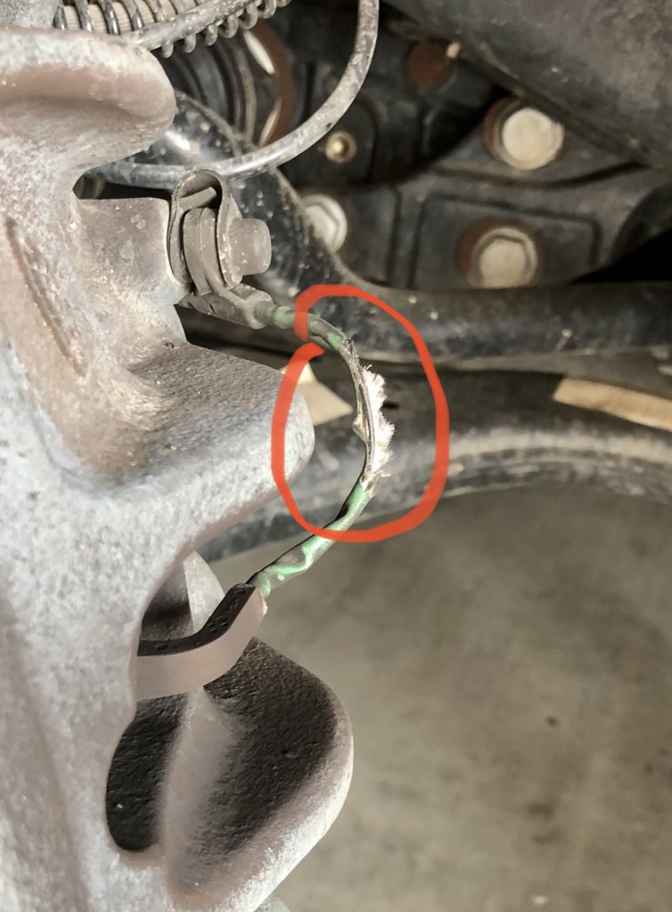

Had my break warning light come on after getting my wheels balanced- turned out the little wire that runs down to the sensor was rubbing against the wheel and had worn through the wires.
