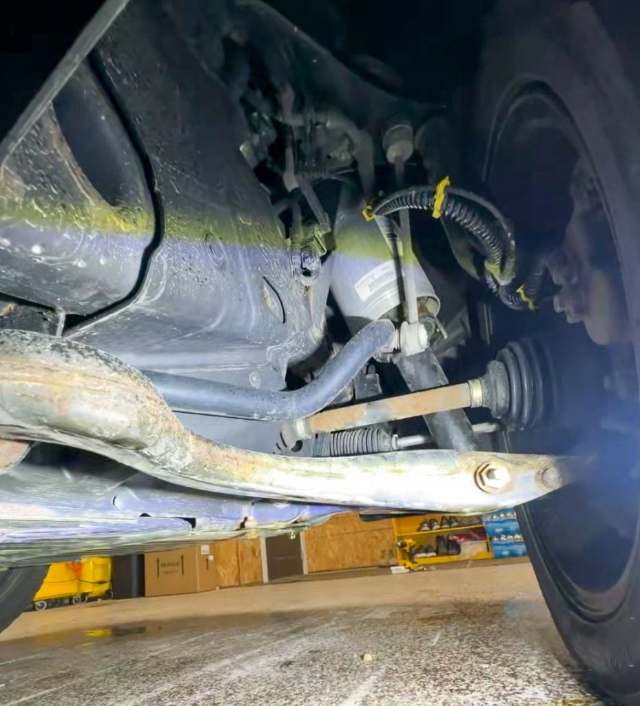

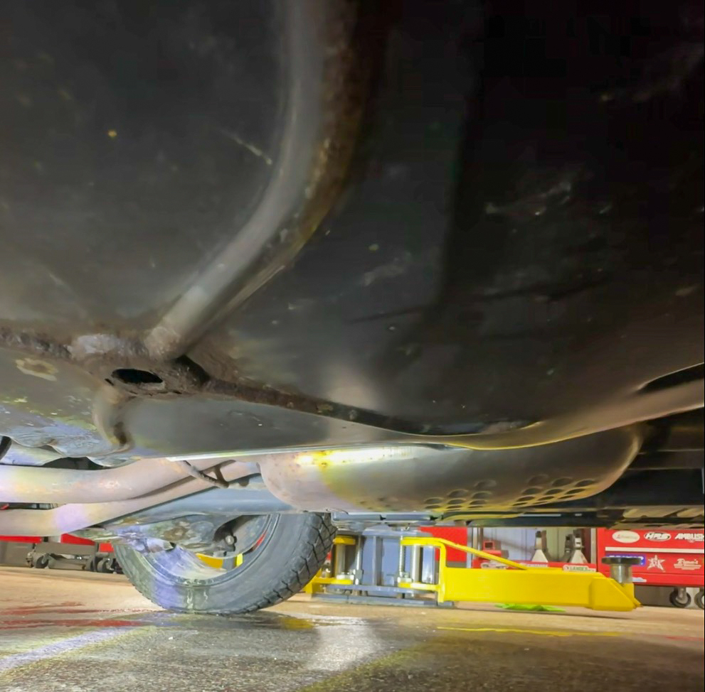

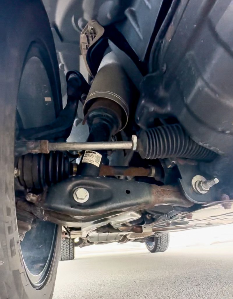

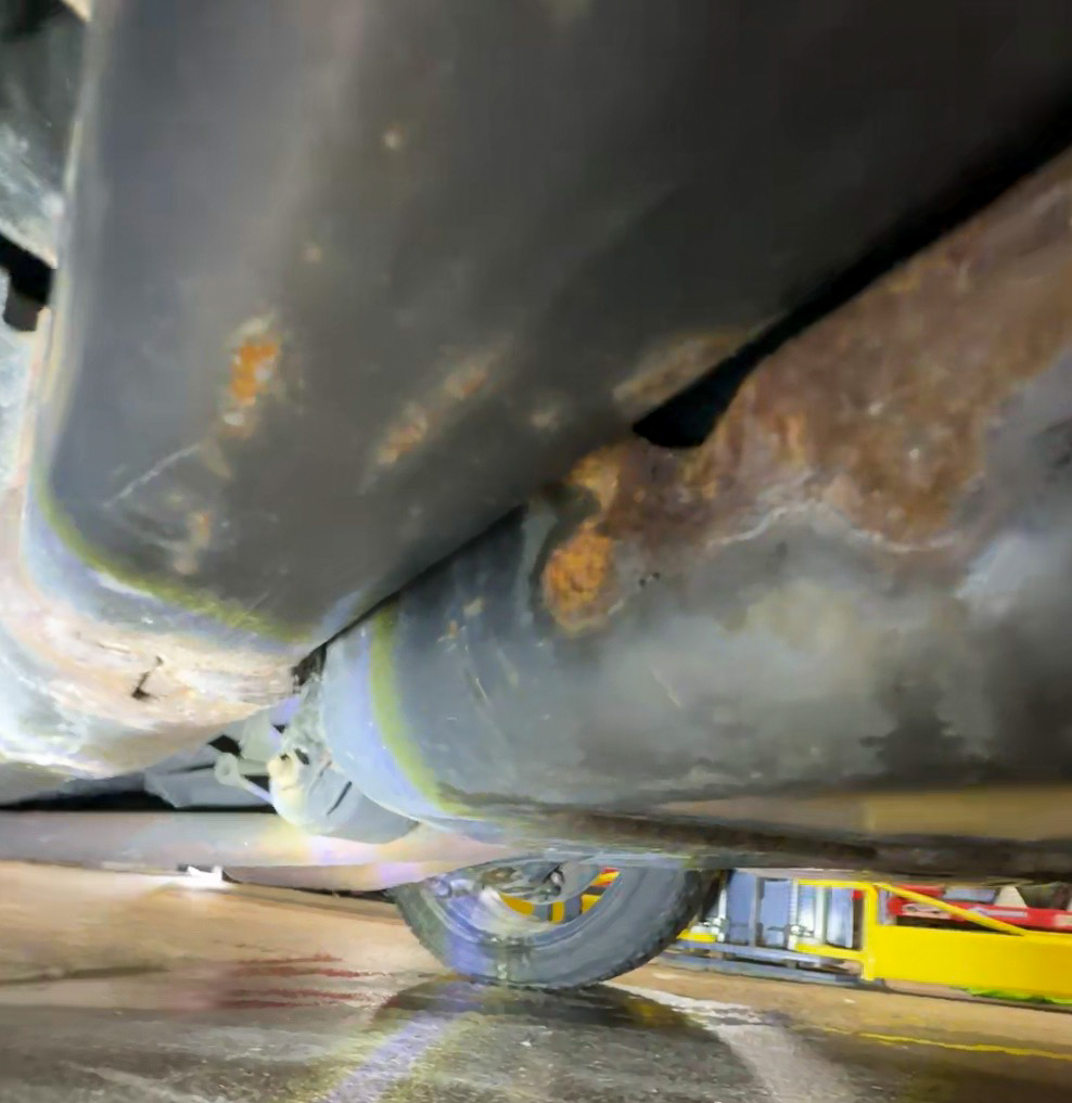

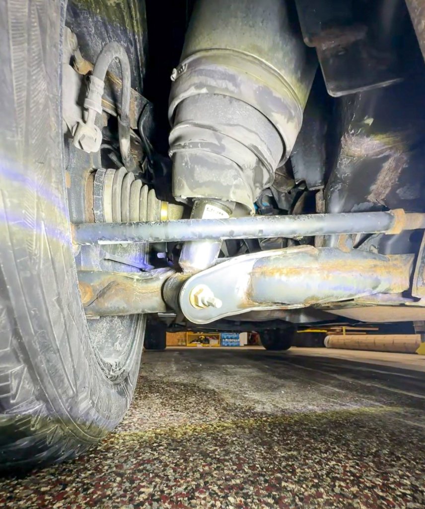

This car has 70k miles and is in perfect shape inside and out, HOWEVER, I'm worried about what I'm seeing underneath! This will be my first Land Rover, and YES I've done the research and understand the maintenance headaches that could come along with keeping it alive. My understanding was that these headaches impact LR4s without rust, so what am I getting myself into when it comes to this example here, which has rust seemingly left and right?
Is the rust on this example not that big of a deal (something you would see on most LR4s these days) and something that can be easily treated? Or do you see this level of rust as a BIG RED FLAG, a purchase I should walk away from and keep looking for the right LR4? I'm sending the car in for PPI tomorrow. Would also appreciate it if you shared any specific things I should ask the mechanic to inspect. :)
I appreciate your feedback/support/guidance!!

It's kind of hard to tell with the photos. It's not great but it doesn't look awful.
Any surface rust I wouldn't really worry about, but it looks a bit deeper in some of the photos. I see you're in Chicago? Is that where the car is located? Seems pretty typical for the rust belt.
You will most definitely spend more time/money getting rusted parts off/apart.
I would wait and see how the PPI comes back. When you start getting a ton of rust/rot on the frame is where I would probably call it quits. You can probably find a rust free example out west, but with the HD package that might take a lot longer to locate.

I agree that doesn’t look too bad. I too owned a Chicago car for a while. I did spend at the mechanic for various seized bits and bobbles. The worst being a seized caliper piston. But nothing that can’t be fixed.

I agree, there's nothing there to worry about! I'm in Michigan, sure, there's rust on the cars!... If chunks of rust/metal are falling off then you need to worry but what you have here is surface rust!

Man thats pretty rust free from where I am located, I purchased a 015 LUX back in August 22 with low mileage with more surface rust than that. If you are looking for inspiration there are 2 youtube channels I regularly watch Notthatkindofachannel and LR time ..if you are really interested in digging deep!

Get rid of it asap. The rust is just the beginning. You will have dozens of electrical issues and what is that liquid running down from the wheel hub? Pretty soon a new timing belt and the list goes on. For what you might pay, but a Toyota
