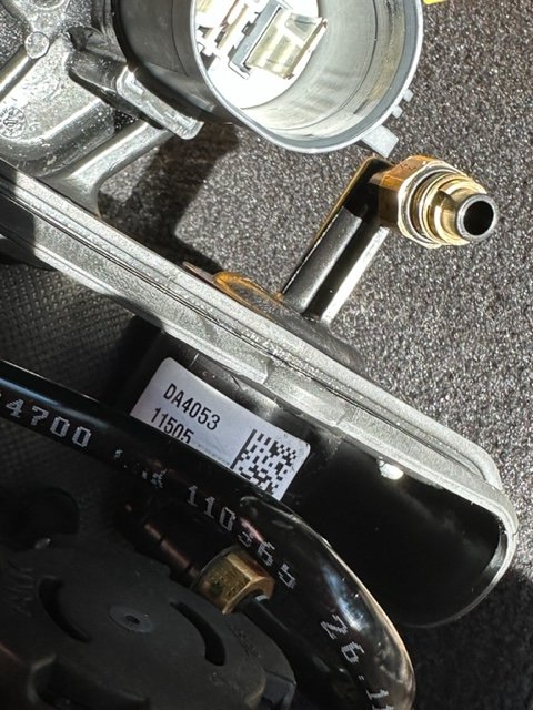

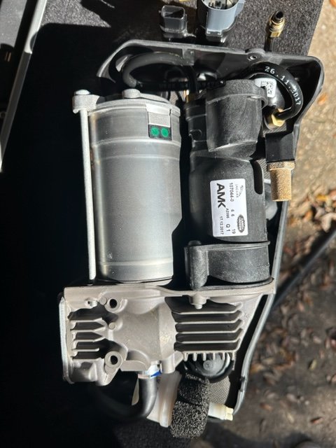

Thanks, I did find it, right where you showed! It is an AMK model and it is single unit with the cover rivetted on; definitely not designed for self help; I drilled the cover off only to find another box riveted also; there is a plastic elbow that looks like it could be a small dryer that's cracked, labeled DA4053 11505; the Google knows nothing about it; going to plastic weld the crack when it can sit for a couple of days to fully cure; I'll report back
CyberTiVo
May 25, 2020
US
Once I got it out, I noticed AMK 110366 & PA66-GF30 stamped in the plastic; the latter seems like the type of material and Google knows nothing of, what looks like, the part number. Based on other markings on the assembly the above is correct.
