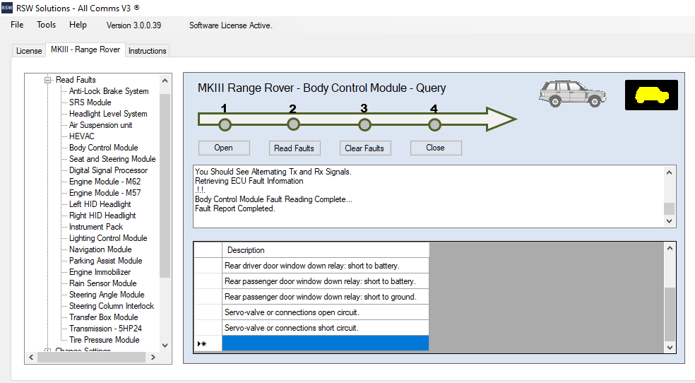

1. BCU (Body Contol Unit) - the computer that is under passenger seat:
Now, I am going to remove the BCU and send it for repair. This repair supposed to fix all these codes that also cause other problemes, like unable to unlock rear doors and/or tailgate, stiff steering, etc.

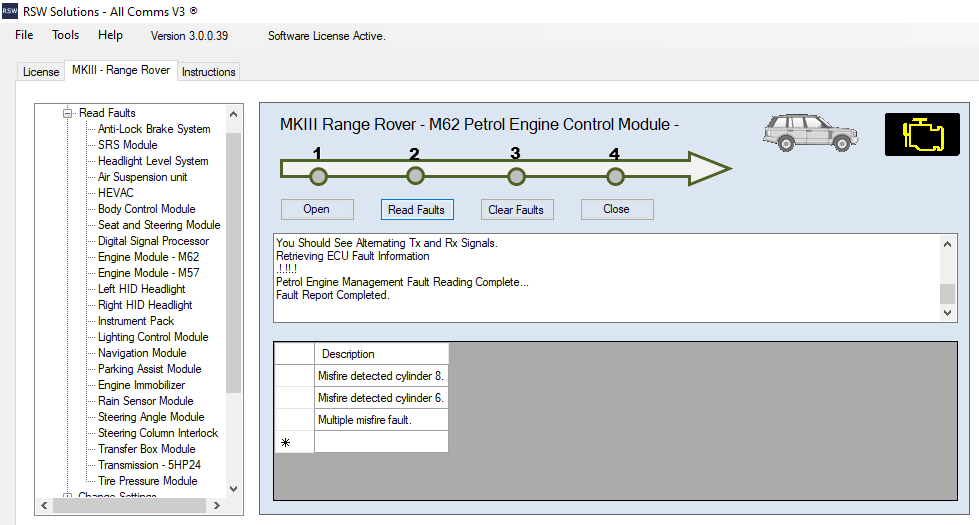

2. Engine Control Module:
I was told that these error are caused by failed mass air flow sensor - engine is getting more fuel that it is needed and the result is also poor fuel economy. In addition to mass air flow senser I am also planning to replace power steeing and all fuids - trasfer case, transmission, front and read diff, coolant, engine oil, break fluid.

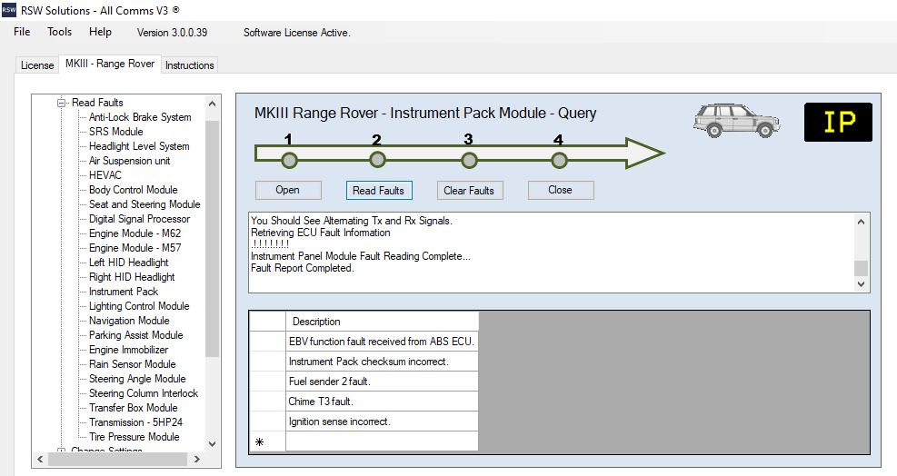

3. Instrument pack
I know nothing about these errors. What causes these?

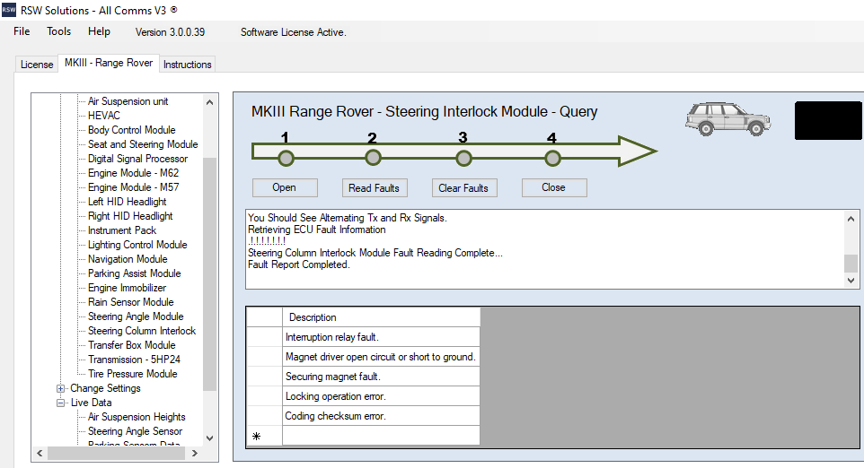

5. Steering Interlock Module. Again, I don't know what these errors are about and what are fixes:

Misfire detected cylinder 8.
Misfire detected cylinder 6.
Multiple misfire fault.

Body Control Module Communications.
Retrieving ECU ID Information
Returned ECU ID : 0 : 10 : A0 : DA : E0 : 3 : 9A : 25 : 10 : 85 : 13 : 30 : 4 : 6 : 32 : B0 :
ECU Part Number : 010A0DA
ECU Hardware Number : E.0
ECU Code Index : 03
ECU Diag Index : 9A
ECU Bus Index : 25
Week of Manufacture : 10
Year of Manufacture : 85
Software Version : 3.0
Servo-valve or connections open circuit
Servo-valve or connections short circuit
