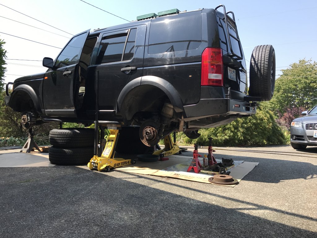

    I replaced every bit of the suspension two summers ago with the type shop and tools you mention. Even being new to auto wrenching I found it pretty straight forward ans simple.

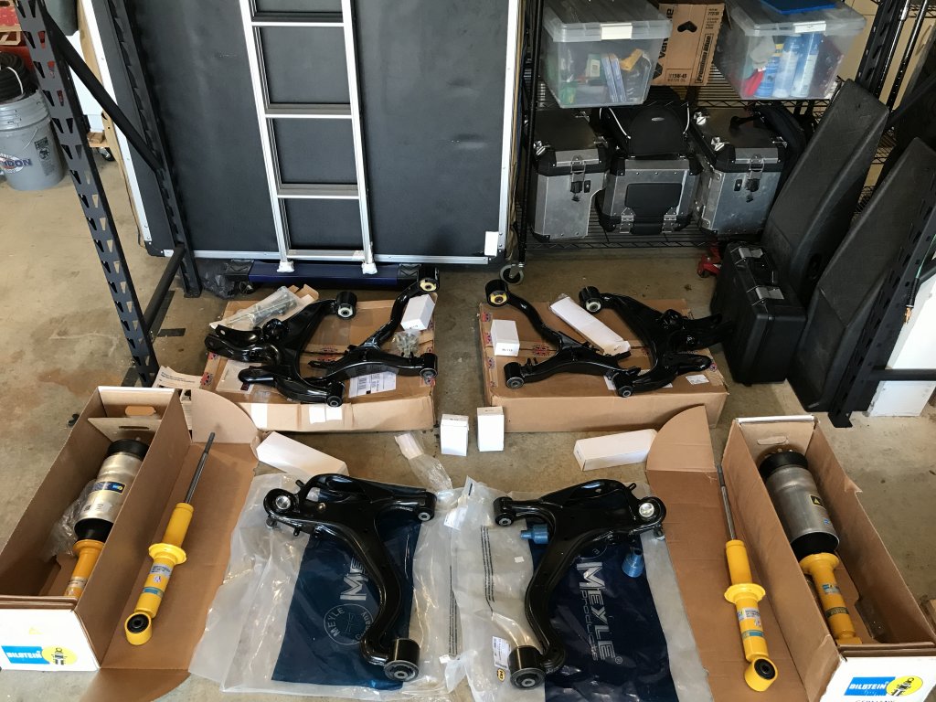

    850B82BE-7304-40A9-BA0D-1BE68B83419A.jpeg 1499B092-6BCE-4C4D-938A-CEB781863A63.jpeg 51B9537C-65C2-45D2-B60E-02CDD8013EE7.jpeg 2A60BDC6-FA6C-444D-88AE-166D48B953CB.jpeg Driveway “shop” ;)

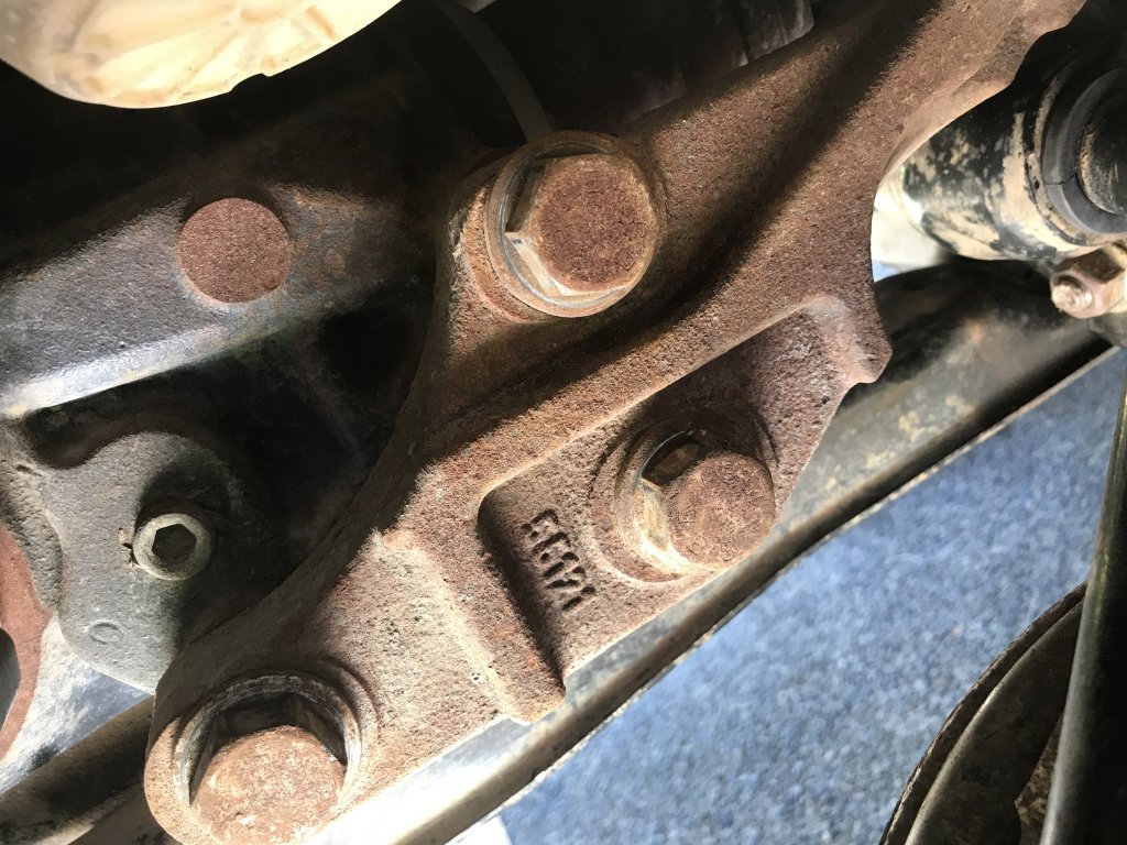

    the two odd photos are to see the surface rusty bracket that holds an engine or front differential item. It's right in front of the driver side sway bar bushing and clamp. It impedes the approach angle to the bolts on the clamp, especially the upper one. Loosening this bracket just enough to allow it to swing out about 10-15mm will make the clamp WAY easier to remove and replace.
    If you think you need any control arm bushings, you also need sway bar bushings unless they were done already. You can see the end link in that other more confusing looking photo. They should be replaced as well for best overall refurbishing results.
    I wrote up a number of things to do and specific tools to use in a thread here somewhere.
    Robin Parsons likes this.
