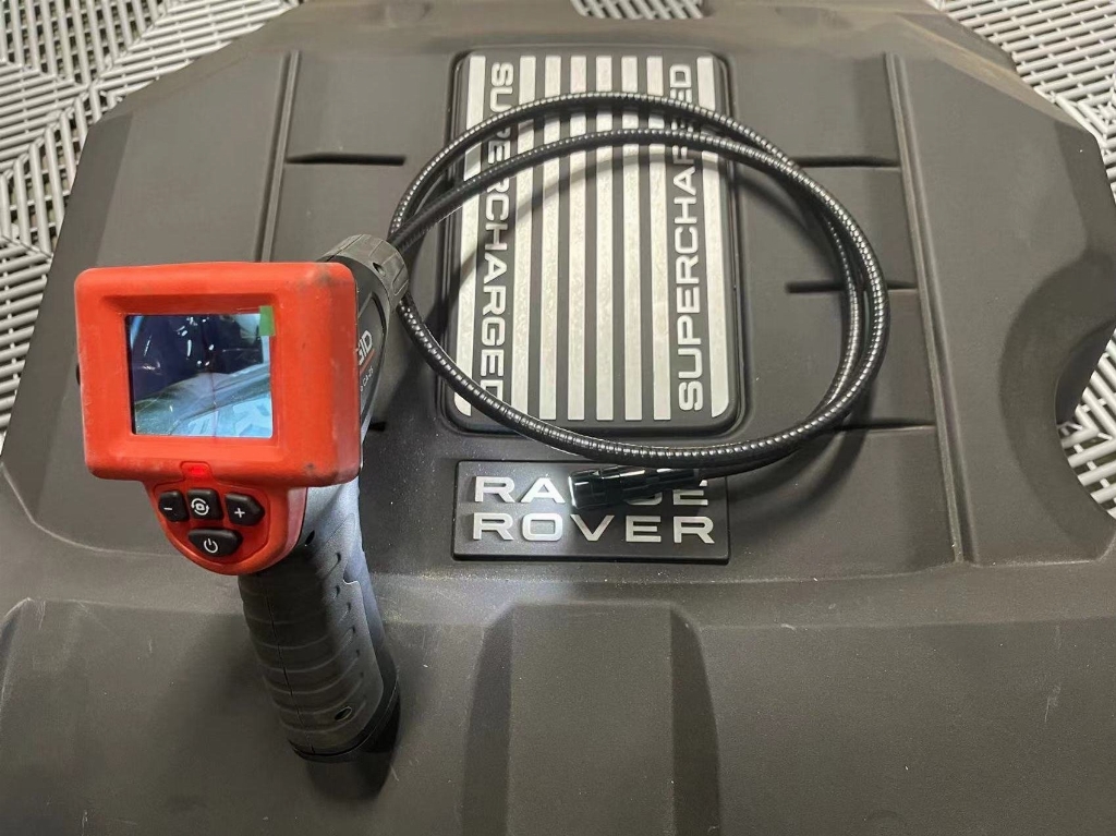

Tool you'll need: Borescope/Inspection camera, I got this one on Amazon.

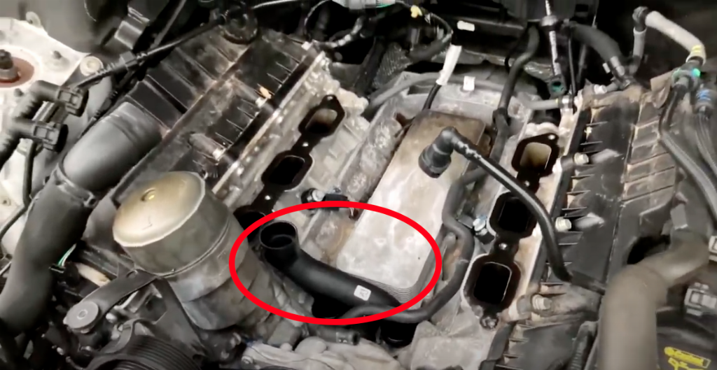

First off all, just to show you the location of the crossover pipe, it's between the block and the oil filter housing. (Not my picture. The one in the red circle is the updated part)
The tool you need is any Borescope/Inspection camera

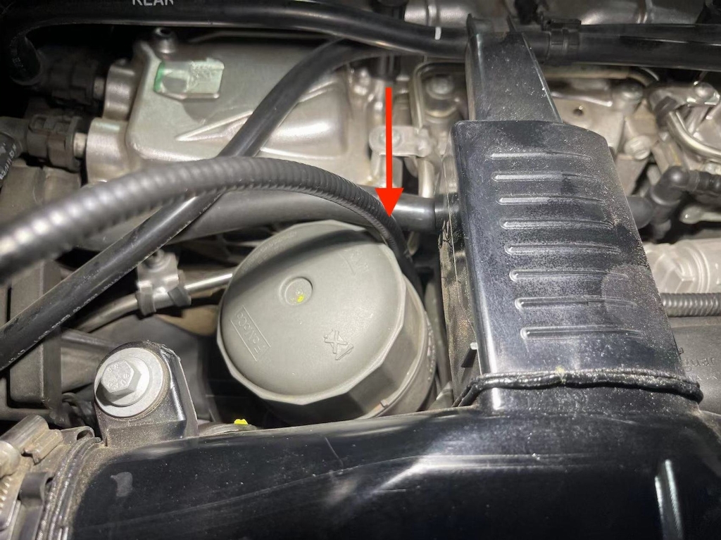

Pop the engine cover and insert the camera into the small area near the oil filter housing.

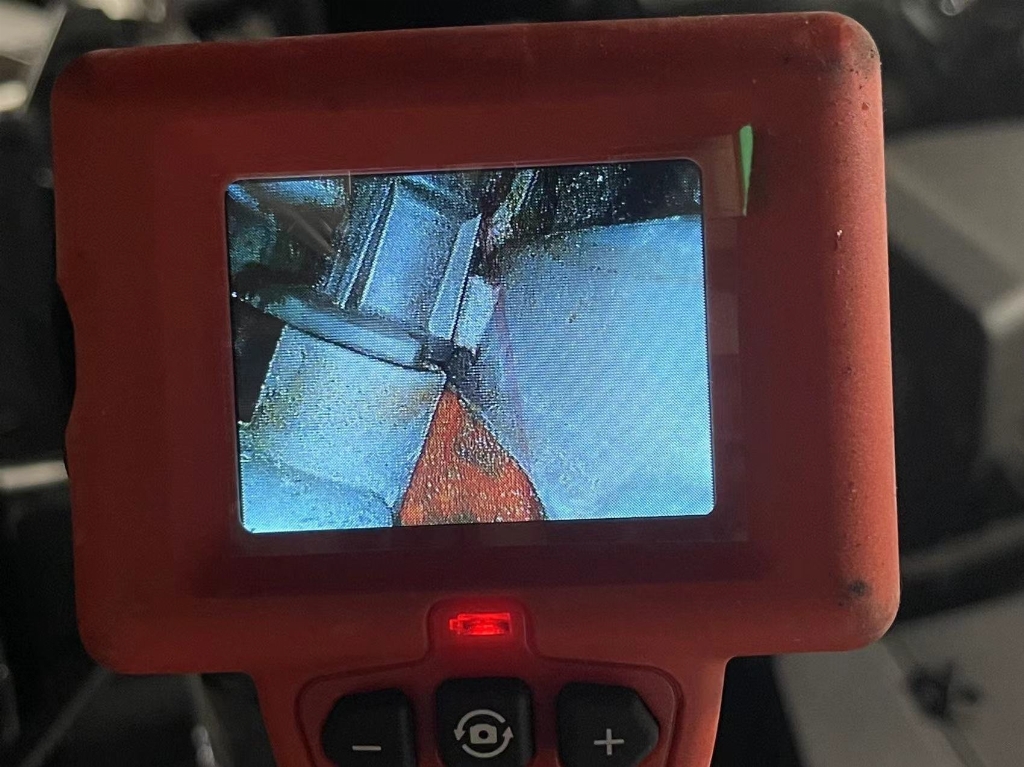

Try a few different angles, try to angle it towards the engine block, and that nasty orange means you just saved an engine.

Huh....... awesome use of technology!
What did it cost?
Can see .any uses for that when trying to detect elsewhere too. Thanks for sharing
3,031
1,803
You can search for "endoscope boroscope inspection camera" and several will pop up. If you want to save some money, they have some that just plug into a laptop and use the laptop as the screen.
