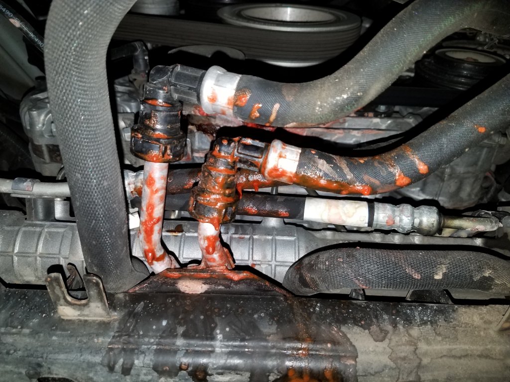

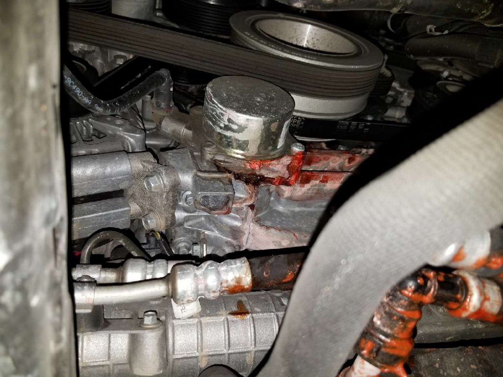

While installing the new sc pulley from velocity ap my mechanic noticed some dried coolant as per the pictures. Now he colluding find an active leak although it appeared to be originating at the water pump. The coolant levels were fine and no overheating or anything. Not sure why this would have leaked but not leaking now. Thoughts?
Is the crossover only something problematic on the v8?
He suggested I get a water pump kit and have it in hand if this thing fails.
Anything else I need to get or other ideas?

Man that is nasty. Your waterpump looks to be toast.
Yeah likely. Still working I guess. And not leaked out much. I want to order the parts but am still confused is there a crossover pipe on the scv6 that needs replacing too? All the threads I see are bout the v8. And I looked at the parts diagram and am not seeing it. What am I missing?

I've been told our SCV6's have cross over pipes. You can see the front one. I haven't bothered to find the rear one... yet. On my last visit to dealer, I brought up the issue of the weak coolant system infrastructure. My tech agreed it's a problem, he ran a pressure test on my coolant system, mine passed. Not sure if that means anything though. I run out of manufacturer warranty in November. :(
My first LR4, a 2014, had a catastrophic oil intercooler failure. Oil entered the coolant system, at 4300 miles.
Something needs to be done by LR to correct this. It's not right.

yeah, just got in there and there is one. although in my case there is no leaking around there, just the pump. i am trying to find out if there is any soft coverage by corporate for the TSB given that my VIN is in the TSB and i am so close to warranty coverage. If not, I will replace the pump, crossover and thermostat and call it a day.

No dealer near me thinks they ever get covered out of warranty so I am ordering the parts myself. Here is the scv6 crossover pipe. https://parts.landroverpalmbeach.com/p/49373519/Lr050934.html
Getting the water pump from Atlantic British and the other stuff from lr Paramus parts department. My local dealers quote me double the price for the parts as ordering them online from NJ. Amazing.
