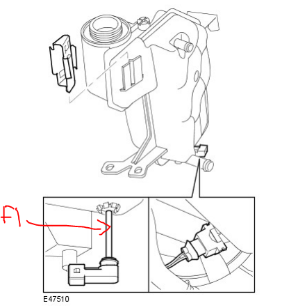

Look at the float in the expansion tank. If it’s stuck or broken then it’s the tank. I just changed my expansion tank as the float was in pieces. The new tank didn’t come with a sensor but I installed and used the old sensor. Works perfect.

?? The sensors I have replaced come with a new float. I guess when I am saying sensor it is likely a dodgy float.

I had the same problem and did the same things - reluctantly changed the tank and all fixed.
The float is inside the tank if I understand correctly.
If so, I am to conclude you were able to also get at and remove the old float? If so, were you able to do all that with the tank still connected?
I ask as I am planning to replace the tank on my LR3 due to the heavy float reality. I just assumed a bad float meant install a new tank.
