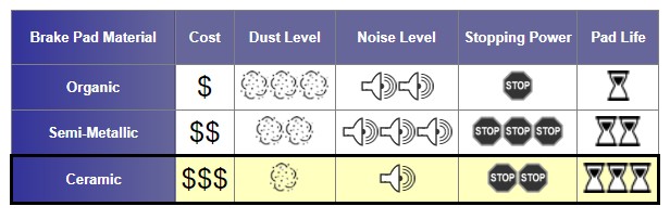

Power Stop is good. They produce all types of pad materials so have no bias in selling one over the other. Their little chart sums up my experiences. Ceramics are cleaner but ultimately don't have the feel or power of original. They can feel "wooden"
