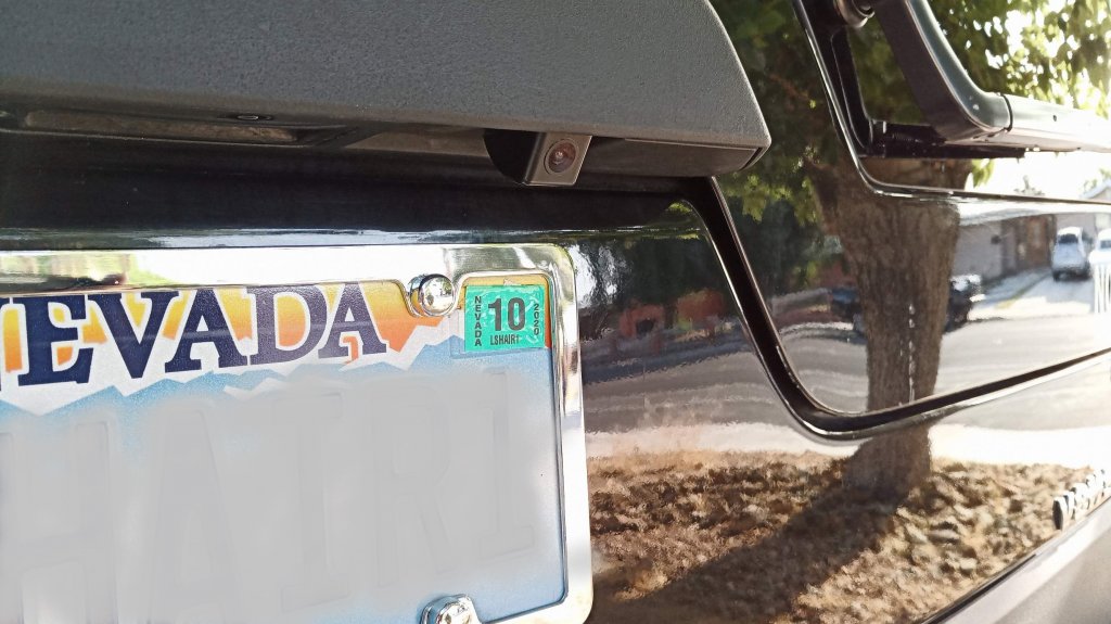

I'm using a Garmin 65 smart drive for navigation on my 2007 LR3 HSE. It fits right over the original nav screen. Garmin has a blue tooth rear view camera which mounts to the license plate and works quite well.

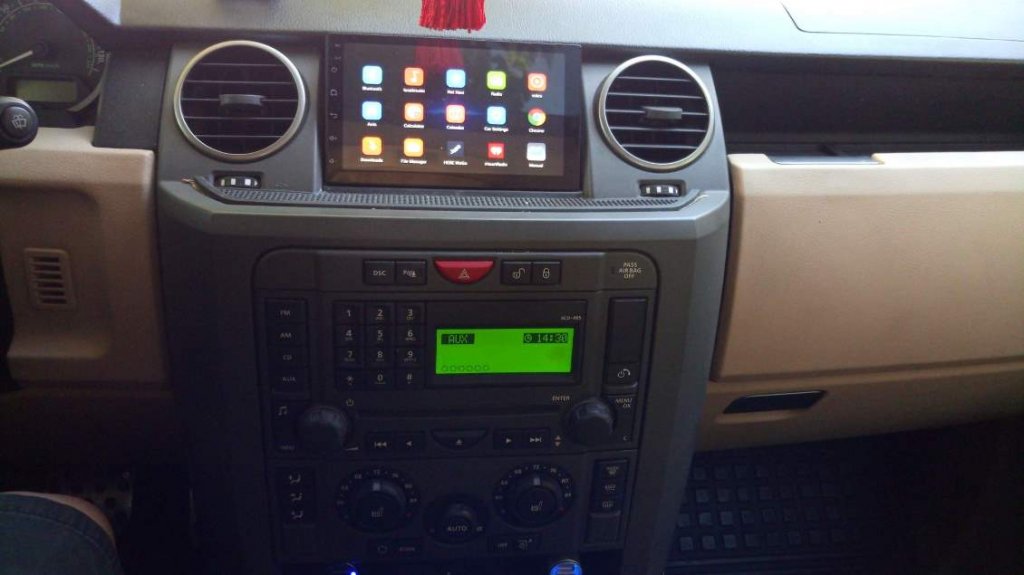

FWIW, here is my setup using a aftermarket Android head unit and rear view camera. Automatically switches to rear view mode when shifting to reverse from any app that is open. 2005 LR3 SE V8

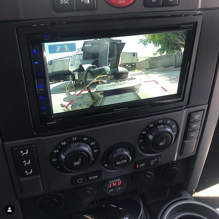

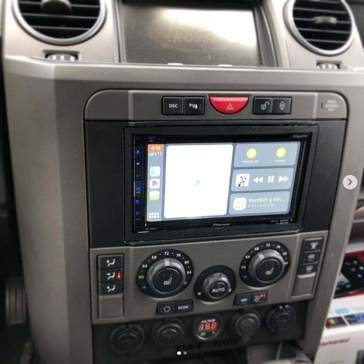

I swapped radios to get my backup camera setup - I like it but I do miss my offroad screen a bit...love the carplay though. I installed it for the exact reason you stated so I could make trailering up a one man show. https://www.instagram.com/p/CC4kL57nIq4/?utm_source=ig_web_copy_link https://www.instagram.com/p/B82jfTrntaK/?utm_source=ig_web_copy_link
yes display works but there is no way to "T" off the optical cable from the new wiring harness for the radio so it just displays Land Rover screen as shown...I'll probably just take it out and put in the standard cubby if I can find on or mount up an ipad for some dedicated gia mapping etc...haven't decided quite yet.
