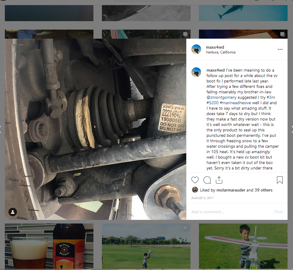

    If it's just a small hole you can actually use 3M 5200 Marine Sealant ($15 at Home Depot / Lowes probably cheaper on Amazon) on it - I did this exact same thing on my rear half shaft 3 years ago and I've had zero problems with the repair. Clean the area really good - scuff the boot and apply liberally - there is one catch though - the 3M sealant takes 7 days to dry (yes you read that correctly) but I've put 40k miles on my repair - on and off road - through water crossings - pulling campers - etc and have never had a problem with the leak again...well worth the dry time. Also I think they've reformulated it for a quick dry now too but I'm only reporting on what I've used personally...I'll try to find a picture but it's been some time.
    Otherwise I'd just pull the half shaft and replace them - refresh all the joints while your at it...that's what I did with my fronts.
    https://www.instagram.com/p/BXZVnSagCkJ/
