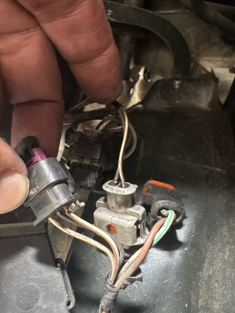

Haven’t checked all injector and coil connectors but seems a few have a bit of wire exposed near the connectors- will this cause issues down the road? Was thinking just some liquid electrical tape as seems suitable for automotive.
