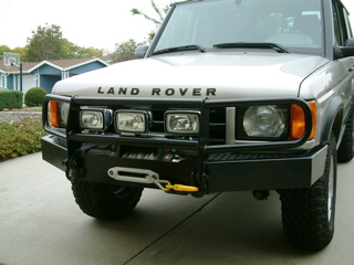

Walter,
You go crazy and build something completely different like I did.
Mike J.

Looks good Mike. I'm gonna start after the Holidays I think.

Have fun with it, I find it kind of neat to have something different from any other out there. If you want to get more ideas at some point get back to me and I'll send you some pictures taken as we made both this and the rear bumpers, might be of some help in your designing your bumper.Take care,

Mike, I know you've posted the "top-down" view of your bumper before it went on the truck. I also know you mounted it to the framehorns by using a separate piece that acts as a brace of sorts -- what gauge steel is that piece? What is the thickness of the other mounting pieces?
D
discomike
Guest
The box steel is 2x6, 3/16th"
The braces and brackets as well as the up rights for the tubes are 1/4"
The winch tray was from 1 1/4" angle iron 1/4" thick
All the bolts are grade 8
If I had to do it all over again, I might have gone to 2x5 box to keep the size down a little in the front. We did use 2x5 on the rear bumper though.
Hope that helps,
Mike J.
