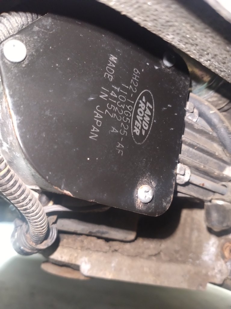

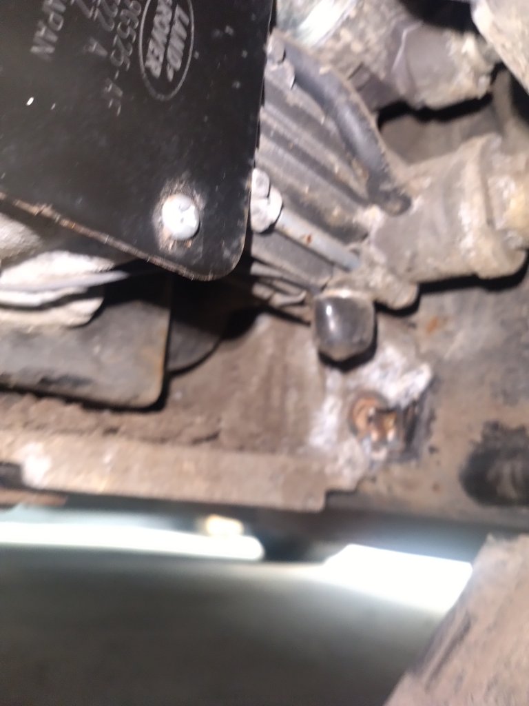

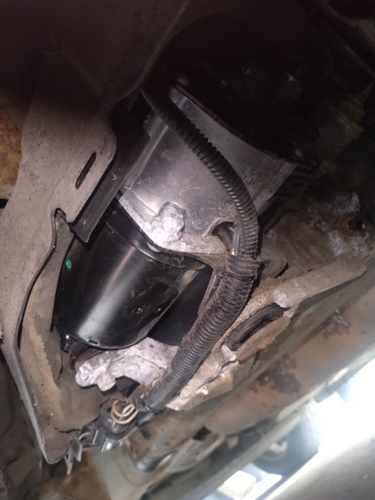

I've got the compressor case off and the brackets so corroded it's split piece missing too video attached and photo of details on compressor all that's on it if you know what type of compress it is from the details that would be a great help so I know which exact fixings kit I'd need ,thanks very much for all your help were very grateful!
