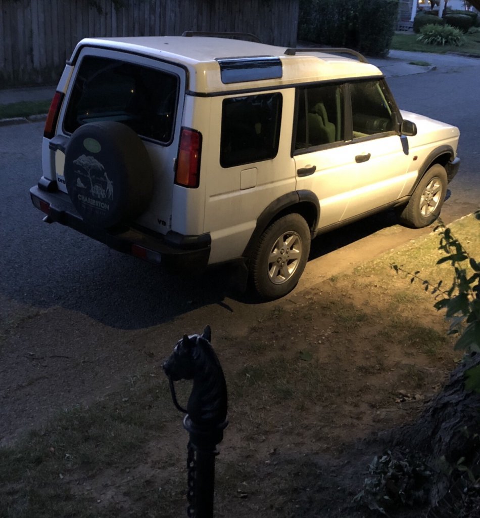

Picked up this 2002 Rover Discovery ll SE Kalahari edition on Craigslist. I got it for cheap but it definitely needs some work. The rear chassis is pretty rusted. There is a small exhaust leak coming from the front of where the silencer connects to the exhaust pipe that goes towards the front head pipe. The engine does have a bit of oil on the outside of it and a very small amount of coolant on top of the engine. I’m thinking this is most likely a headgasket issue. Since this is my project/beater truck I’m thinking I might get a bottle of blue Devil and cross my fingers. Any advice and or encouragement on any of these issues is much appreciated. ha thanks.
