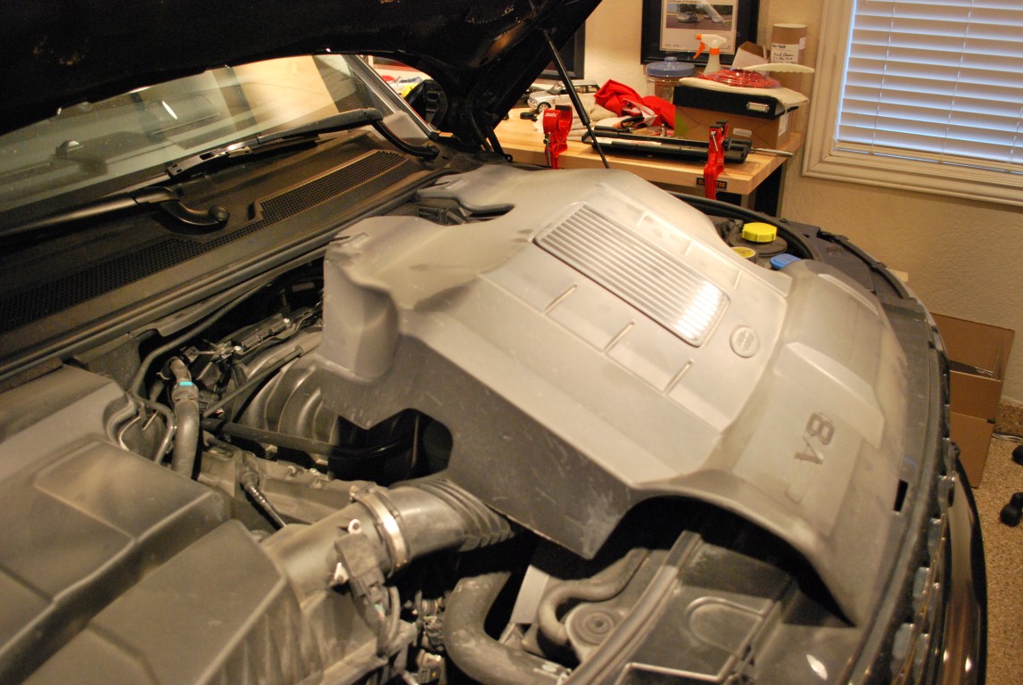

1) Raise the hood of the LR4
2) Find the big plastic cover over the center of the engine. You can lift the front up, and remove by pulling forward. It is connected in the back with two rubber grommets which act like hinges. Just tug forwardly slightly to remove.

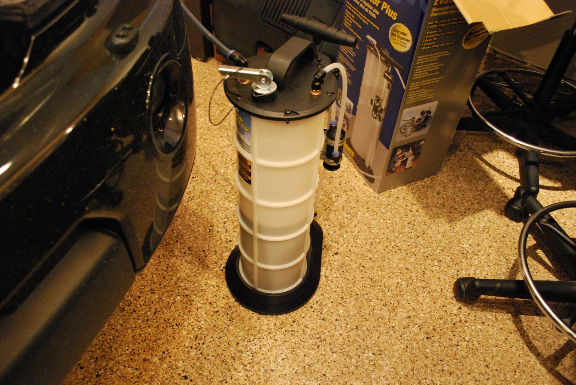

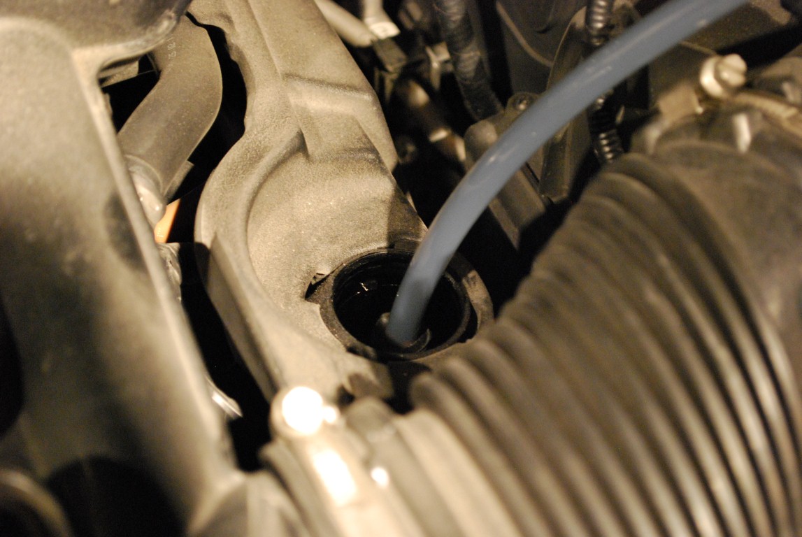

4) REMOVE the BLACK CAP with yellow lettering, and place aside. Grab the Mityvac (their directions are okay) and position it on the ground close to the oil reservior. Inside the oil reservior is a smaller inner tube positioned almost perfectly in the center. This is the tube to which you will connect your large plastic hose from the Mityvac. Just put that big Mityvac tube (plastic) over this inner tube (metal) (see PIC)

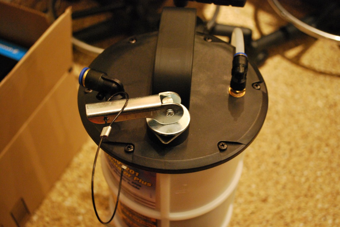

5) Make sure that one end of the big, plastic Mityvac hose is secured to the Land Rover's "Inner Tube" in the oil reservoir, and that they other is locked in place on the Mityvac.
6) "Close" the metal lever on the top of the Mityvac to close the system. This will enable suction (ask me how I know!)

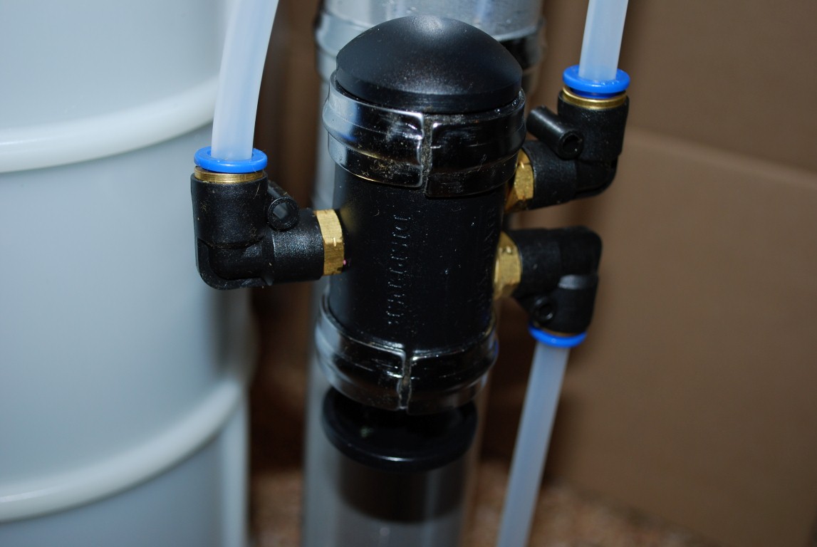

7) On the side of the Mityvac is a pump system. On the pump is a switch (see pic) that says "DISPENSE" and "EVACUATE". When the button us pushed DOWN, it is in the EVACUATE postion. This will allow you to generate pressure to suck the oil out of the car.
8) Pump the Mityvac around 10 times. Almost immediately, the tube will turn black with oil as it sucks the fluid out of the car and into the Mityvac. Every few minutes, I needed to pump a few times to speed the flow. Total evacuation of the 8 quarts took about 10 minutes.

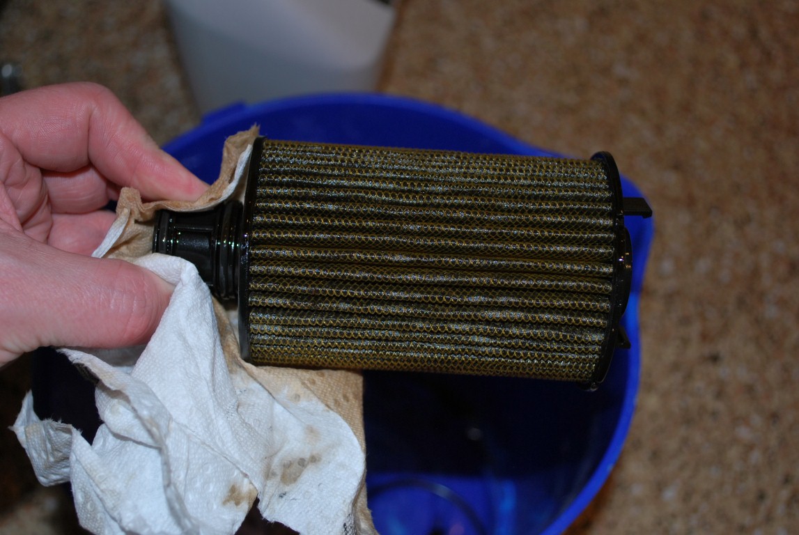

9) Now that the oil is out, time to work on the Oil Filter. Attach a socket wrench (3/8 for my oil filter) to the oil filter wrench. Rover does a great job by noting on the filter housing not only the direction to tighten (righty tighty), but also the proper torque (25Nm).
10) Remove the oil filter housing by turning to the LEFT (COUNTERCLOCKWISE). The filter is held inside the housing COVER by two compression clips (you can see those two black clips on the oil filter in the pic below). All you need to do is pull softly on the filter and it will pop right out.
11) Clean housing with a rag, and add new O-ring that came with the filter to the housing. Make sure not to allow the O-ring to twist. I also like to rub some new oil on the O-ring to lube it up a bit....
12) Pop the new filter in the housing, and then screw it back onto the car. Tighten to 25Nm. (NOTE: my torque wrench could not get into the space, so I hand tightened it. Be sure NOT to overtighten as you can crack the housing and those are $100 or so from what I understand to replace)
13) With oil drained, and filter replaced - now it is time to pour in the 8 quarts of oil! I used to funnel to prevent spillage....
14) Put cap back on oil reservoir & put engine cover back on engine
15) Start the car up, let the oil circulate - and when the engine is cold again, check it using the dash computer!
16) Dispose of the old oil, oil bottled and old filter & O-ring. Most auto parts stores will take the oil from you for free...
YOU ARE DONE!

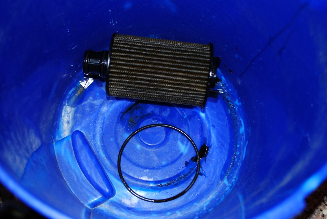

(Pics of dirty oil filter and O-ring below)
