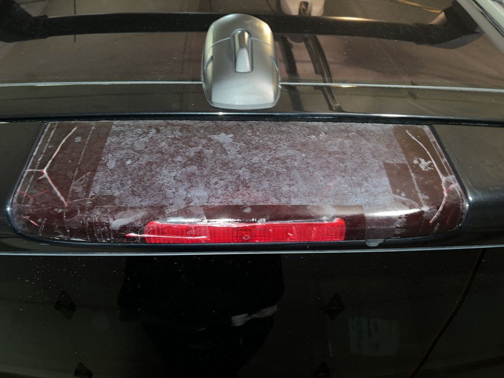

Sharing a quick how-to with on replacing the third brake light on the tailgate of a lr4/lr3. I recently replaced mine due to faded discoloration and water intrusion into rear tailgate through various cracks. All leaks have stopped after replacement.

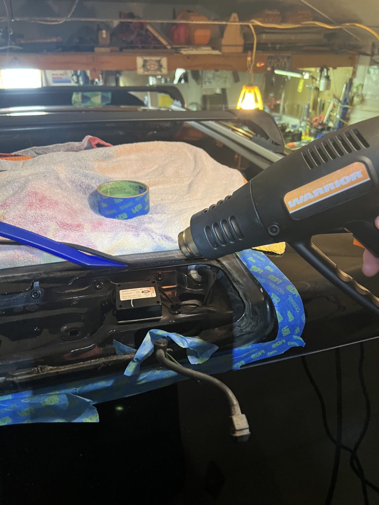

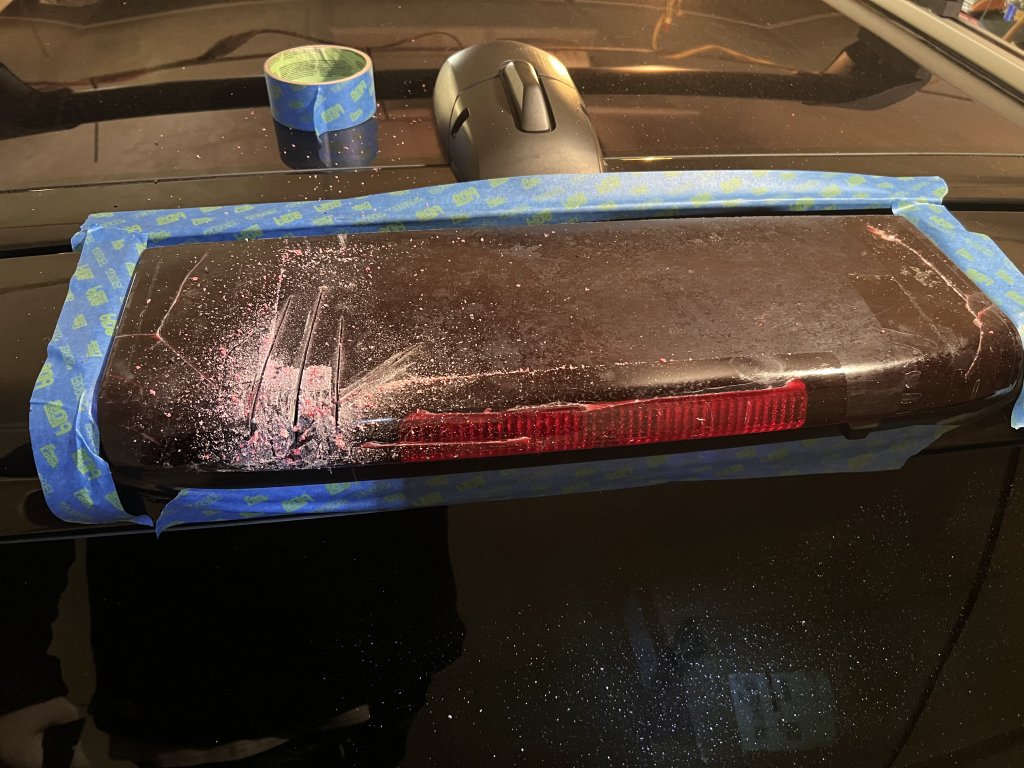

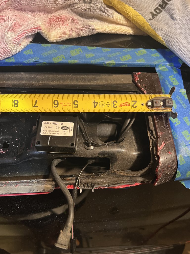

1. I first disconnected the ground terminal - I made three cuts on the left side, with a saw-zaw. Would recommend something more precise but it’s what I had in the moment.

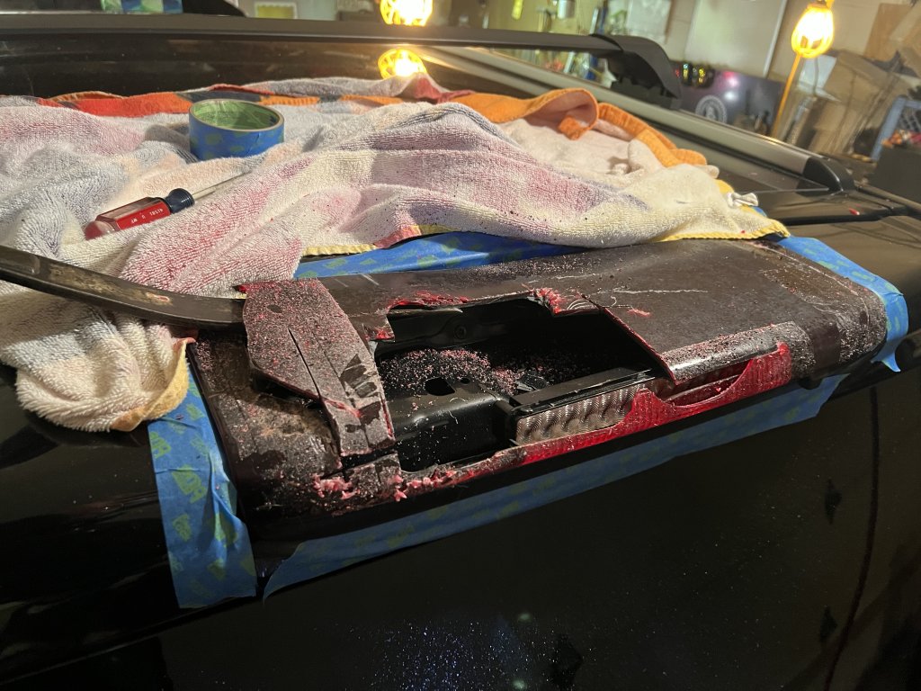

2. Cut across so you can pry those pieces up to gain access to the interior of the light cavity. Use a pry bar (but be careful to not sink it into any metal) to break the plastic to the seal.
3. Once you’ve reached the seal, work your way around with the pry bar, keeping it between the seal and plastic. This will prevent metal on metal contact.

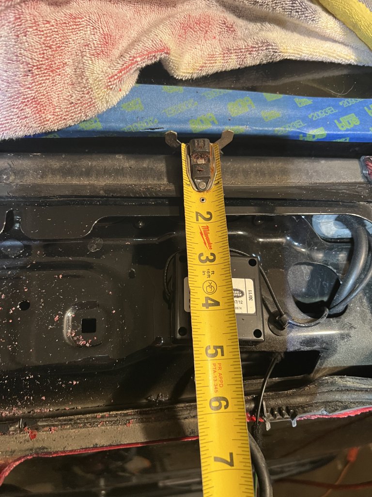

Watch out for the sensor and wiring on the right side, pictured below.

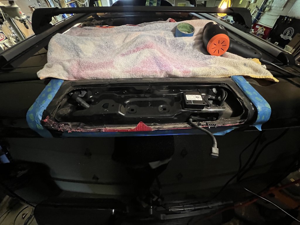

4. Once you’ve removed all the plastic, you’ll be left with the old adhesive. I vacuumed the shavings up, and then applied googone to the leftover adhesive, and used a heat gun to warm up a few inches and then a plastic trim tool to remove it off.

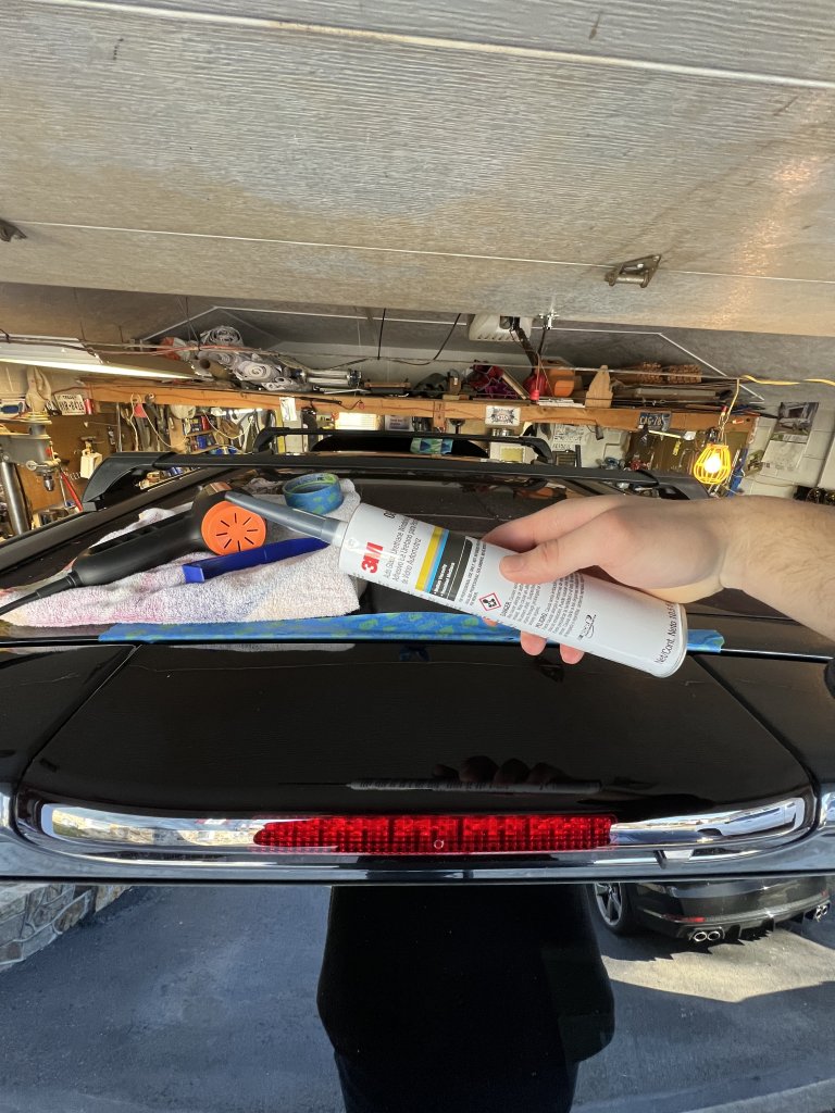

5. Once the surface is clean and even (minimal residual adhesive) you are ready to apply the 3m adhesive. I did a few practice runs on cardboard to get the bead width right (about 3/8 to 1/2 inch). I applied over the old adhesive generously.
I then carefully connected the wiring connector and washer jet tube, and then gently laid the new light assembly on. I didn’t see a need to press-fit it. Seal is now 100% with no leaks.
Good as new! Best.
