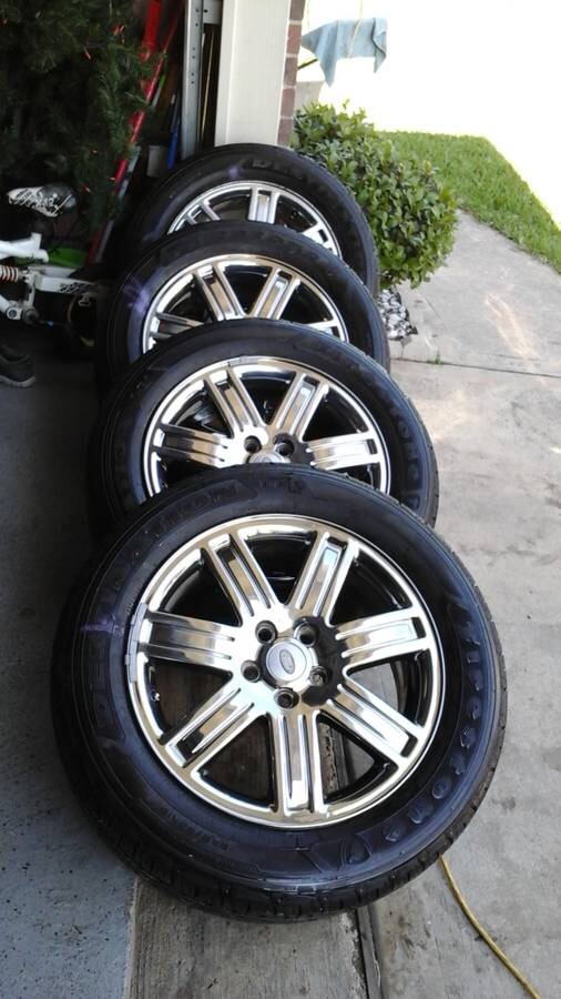

I found these 255/65 Range Rover tires on craigslist. They’re a cheap choice for me while i save up money. That is if these fit. Do you know?

Those may not fit correctly as they are from pre 2007 when the wheel centering hubs were definitely the same as an lr3 and lr4. You will need to do some careful research though because the hub of Range Rovers and the wheel mounting may have changed yet again in more recent times.
That when though is from 2003-2006 when it had a BMW engine. In 2007 pretty much the entire vehicle was redone ground up. Engine, transmission, body, interior, probably the frame as well but the wiring harness, everything really.
Those look like a waste of $ 100% in my opinion. Doesn't your lr4 have wheels? Those in the photo are 19". What is your plan for the lr4 and what are you "saving up" for anyway?

And how old would those tires be? The wheels are at least 13 years old and will not have compatible tire pressure sensors if any at all - if you care.

It looks like they were already refinished and who knows what the offset is. As noted above the center bore could be the wrong diameter. Just find some LR3/LR4 wheels if you want another set of 19" wheels.

Wait not so fast. I am running the same wheels as my winter set. I can confirm that they fit LR3 and LR4, use the same lug nuts and they have held up really well over10+ winters. They have slightly more offset so they are pushed inwards a few mm over a standard LR4 19" wheel. Not noticeable. The wheels in your picture have been refinished (chromed).

Now that I think about it, that makes sense anyway because the P38 shared the DII hub interface and then both the next gen RR and LR3 would also share.

yes they fit no problem. i use the 19s from 2007 HSE on my 2013 LR4. those tires sizes arent the oem ones though - my 2007 19 in rims have 255/55/19 - same as the LR4 19s.

I tried a set of 2003-2005 Range Rover 19" wheels on my LR4. They fit fine, but do not accept TPMS, and require different lug nuts. The wheels in your photo appear to be the same design.

05 I’m not sure about - mine are from 07- pretty sure those were not available on 05s but not certain
