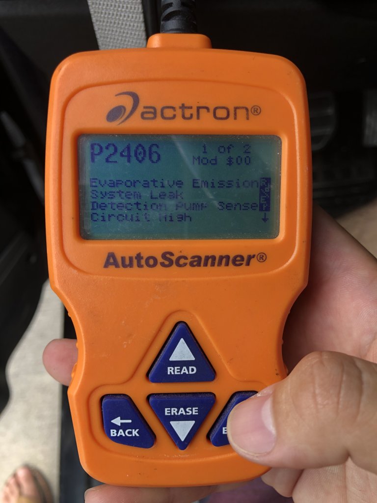

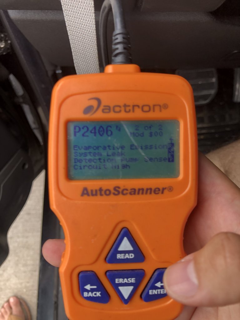

    A06B8F35-DE83-4B45-B605-AC6B12536989.png 60E62E5B-1F4C-41F5-8BEB-3C0B78FADE33.jpeg F1EE99C0-B551-40FF-B351-D207140F67B5.jpeg My check engine light went iff. Oil change was done very recently. It is not overheating at all. There are no funny sounds. It doesn’t feel funny when i drive. Yet, there’s the light sonits something for sure.
    I have a $100 scanner, not that fancy $500 one i imagine someone is going to siggest I get. My scanner gave me this code (see picture).
    I’ve attached the image of the scanner, along with the google explanation of what the code means. However, I’m an extreme layman when it comes to this.
    I’d appreciate someone with patience to explain this to me in Simple layman’s terms.

    Do you top off your tank a lot/overfill?

    Perhaps a loose gas cap, had you just refilled?

    P2406- 00
    Evaporative Emission System Leak Detection Pump Sense Circuit High - No sub type information
    Diagnostic monitoring tank leakage module circuit, short circuit to ground, short circuit to power, open circuit, high resistance
    Blocked pipework Diagnostic monitoring tank leakage module failure
    NOTE: Operational requirements needed to allow the monitor to be fully tested. Ensure that the vehicle has a fuel level between 15 and 85%, ambient temperature is between 32°F and 95°F, Ignition is on. Using the manufacturer approved diagnostic system carry out a "large leak test". Allow the diagnostic monitoring tank leakage test to complete, refer to diagnostic monitoring tank leakage test results
    Refer to electrical circuit diagrams and check the diagnostic monitoring tank leakage module circuit for short circuit to ground, short circuit to power, open circuit, high resistance
    Check for blocked pipework Check and install a new diagnostic monitoring tank leakage module as required
