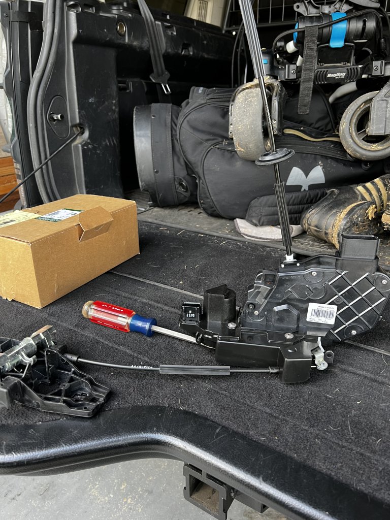

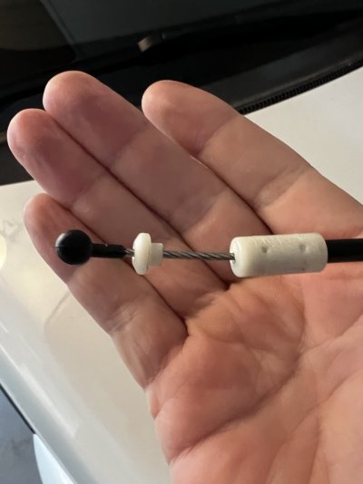

My passenger door lock stopped locking. You could open from exterior but it would set off the alarm. The actuator sounded like it was working but I remembered the rear hatch actuator still made the noise when it was failing. Anyway I ordered a new actuator and lock latch to actuator cable and installed it. What is of note is that the white plastic bit on the old cable is broken. It was in my head that this served only to hold the cable against the door so that the metal head would not pop out. However, when I installed the new bit I did not pop it back into the harness on the door properly and after reassembling the door the problem was still there. I disassembled it and popped the plastic piece back into the harness and that solved the problem.
