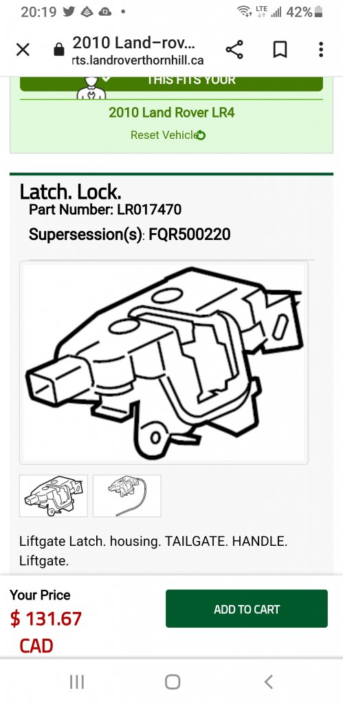

Can the latch be adjusted or lubricated?
Its $CAD 131, so prefer not to replace unless I have to?
