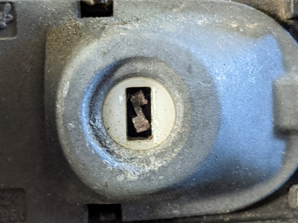

Sorry to veer off topic, but at least you don't have to deal with this:

Omg man, yeah luckily no key snap!

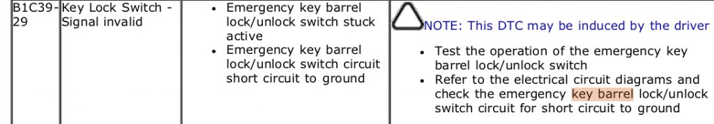

This has me concerned because I always thought of the blade key as an almost foolproof way to get into the truck, i.e., if I lose my key when I’m out in the middle of nowhere. So, I started looking at the service manual, and apparently the key barrel is not truly a mechanical lock. It appears to be just another electrical switch activated by turning the mechanical key. I say this because of this passage below referring to a fault code for the key barrel “switch.” That suggests that the blade won’t work if the battery is flat dead (though it probably only requires a tiny bit of energy). Seems hard to believe there is no purely mechanical way to access the vehicle.
To the OP’s problem, this could be an electrical problem? Maybe look for a code?

I just assumed it was mechanical too, but now that I think about it, when I used the emergency key prior to the issue it unlocked all of the doors (and locks all doors as well) What a great point, It must be a short or something which would explain why it still locks the doors fine, just shorts on unlock. Thanks for checking this!
I'll have my guy check it for a fault and follow up with everyone
