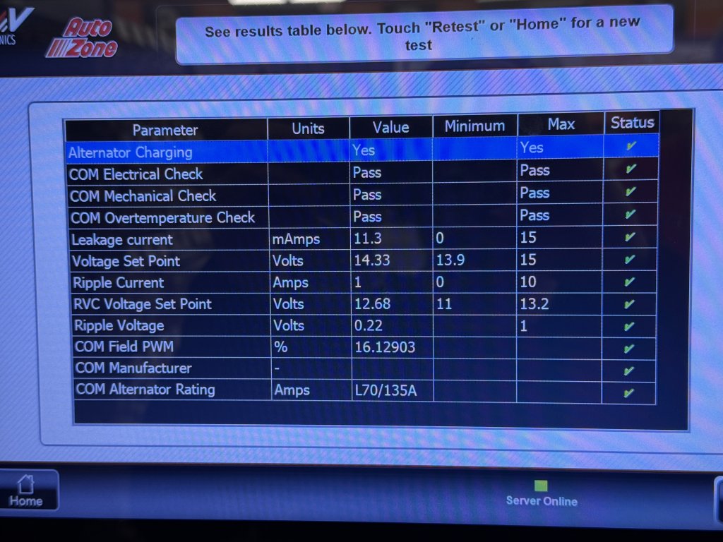

  8. Removed alternator and had it tested at Autozone. Passed test with around 14.33 under load.

Here's a pic of the test results:

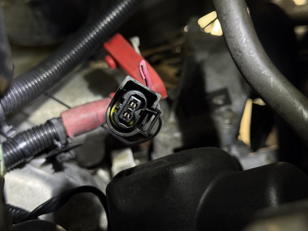

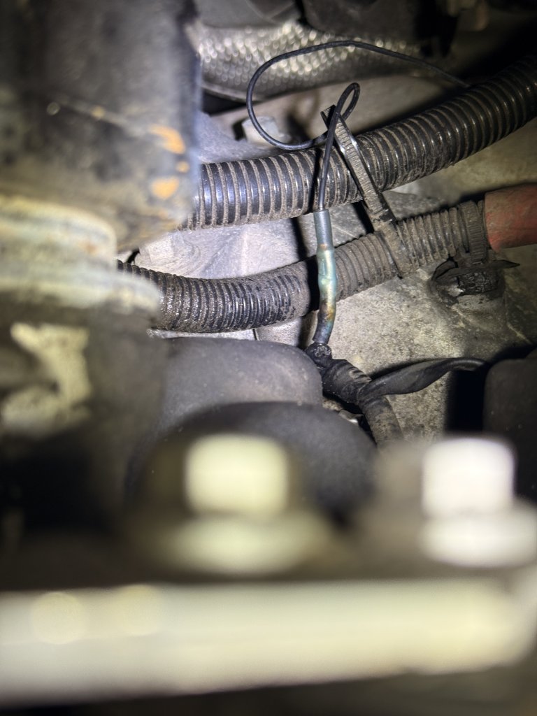

Removed the alternator from the '19 D5, installed the one from the D4... no fault codes on the D5.
However, I noticed the alternator LIN wire was replaced with an aftermarket pigtail at some point. (see pics). Looks like they modified the connector to make it fit.
I ordered a replacement.

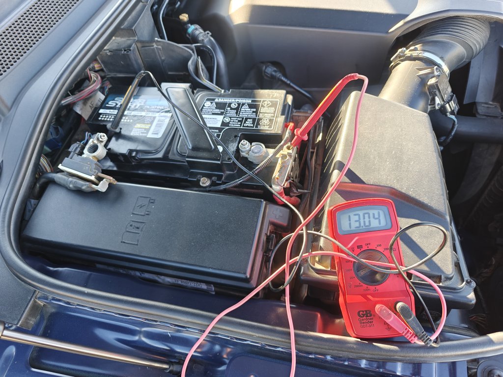

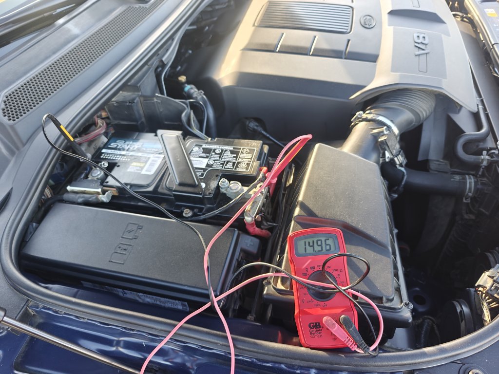

Putting a volt meter on the battery with the engine running shows the alternator is putting out 14.9V and not 14.5V like I mentioned earlier in the thread. Then after shutting down and disconnecting the battery cable it sits at 13V. 12.9V+ is charged.
