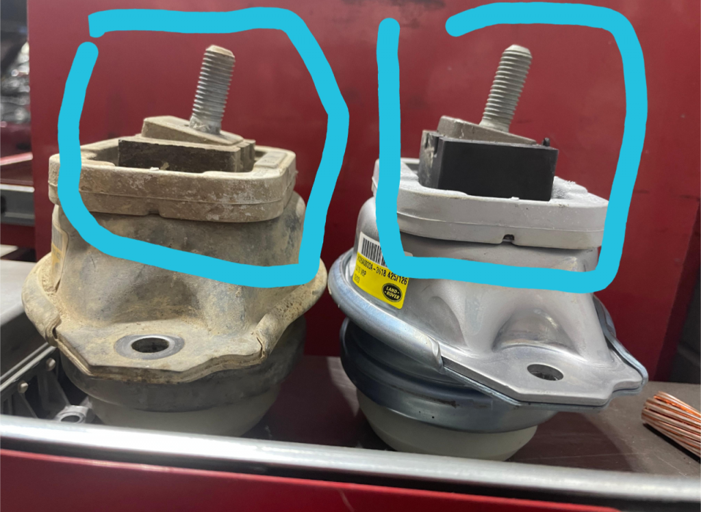

Seems really odd but in regards to the fan code,I replaced the fan then shortly after received the code again. Around that time, with 128k miles on the clock I thought it would be a good time to change my motor mounts before my next trip...I did that and the code went away, which also kept my vehicle from running hot going downhill on trails which I noticed on a prior trip. If the motor mounts are blown, it could potentially cause the engine to sink forward and place weight/force on other components. There are other posts that detail the same issue. I can't stress how important it is to change these on high mileage rigs, it will prevent downstream impact and allow your vehicle to be more dependable. Attached is a pic of how bad they were compared to the new ones.

just finished dealing with Fan codes due to motor mounts causing fan to hit the brushes that are on the lower fan shroud. I just removed the brushes from the shroud for now as I don’t have time to do the motor mounts so my prob is temporarily solved.
