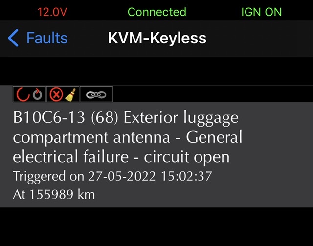

Hey all. I’ve got a rear trunk that no longer allows me to open a locked trunk keyless by just touch. I’ve got a code for it. Anyone happen to experience? Only thing that’s different is I disconnected parking sensors from the oe bumper when I added the T44.

I'm going back a lot of years here, but IIRC, you must leave the parking sensors connected for things to function normally. Deactivate them with the IID tool, but then zip tie them up out of the way.

Hey thanks buddy. I appreciate that. I’ll double check but I do believe I already had the rear sensors deactivated when I did the fronts for the front bumper.
At least it’s a minor annoyance but I actually appreciate that feature.

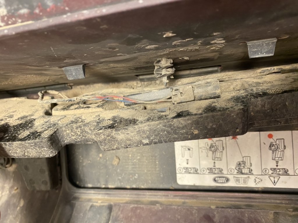

Ok found the antenna. It’s located under the rear bumper cover foam, center section. So if you delete your bumper as I did, you’ll need to reinstall the harness and antenna to maintain functionality.
