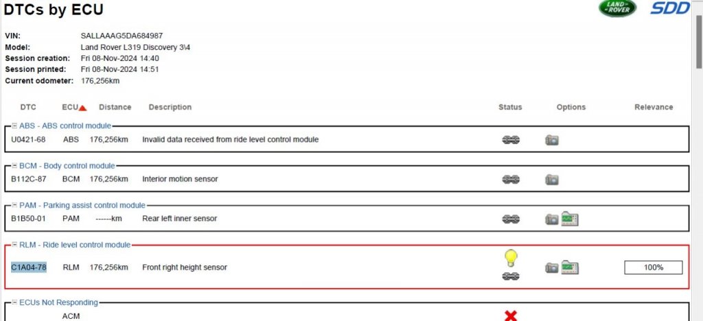

I have an SDD connected to the vehicle via a Mongoose cable. The front right height sensor has a permanent error. See the attached photo.
