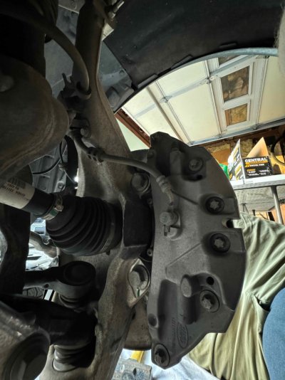

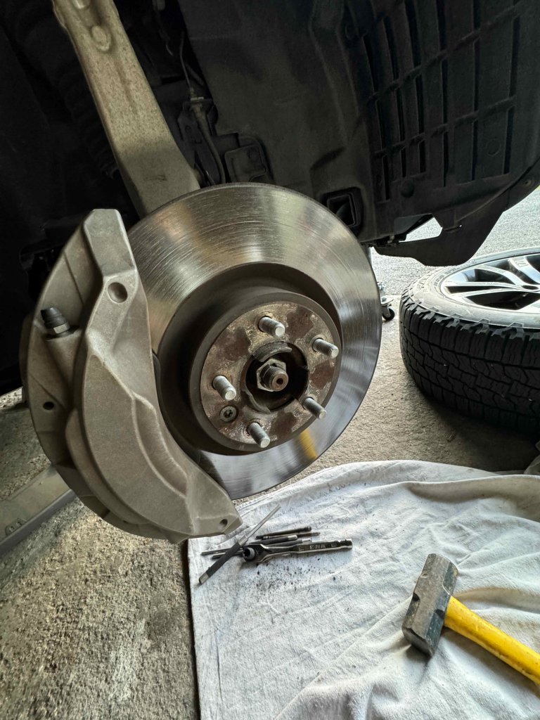

New configuration to me. There is no access in the rear of caliper to remove front brake pads after removing pins. Can anyone explain the process to remove and replace pads? Can rotors be turned? How to remove rotors too perhaps?

The caliper needs to be removed to access the pads.
Before you remove the caliper, the pistons will need to be pushed in.
This is done by prying the pads apart (at the same time) with two screwdrivers.
Remove the pins and the pads will come out.
JLR recommends new rotors.
Remove the T50 torx bolt and tap on the rotor with a hammer to remove.
