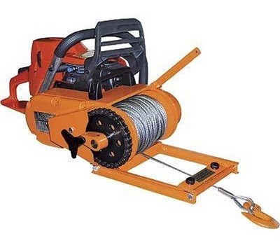

I'm thinking you'll need to fab the front hitch and the rear hitch would be rated at the minimum the towing capacity. I, being a serious risk taker would rate it at the minimum of what ever it took to winch myself out. Another option would be a gas powered winch (usually powered by a chain saw engine) that you secure to a tree and attach the tow line to your car.

IDK…if I‘m going to do something like a chainsaw winch, I might as well adapt a 5 ton Harbor Fright chain hoist for the purpose, or just use a HiLift. Or just a second, smaller winch on a hitch tray.
