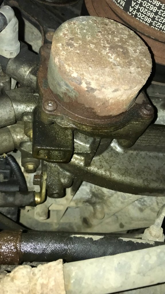

after hearing a noise from a pulley while idling I popped the hood to take a look, unfortunately what I found was the start of an oil leak. Just changed my oil maybe 3-4 weeks ago and it wasn’t there. It appears to be coming from a weird engine mounted accessory or.....the timing chain cover( I’m assuming that’s what the black metal plate is) anyone ever seen a leak in this location before or know what part it could be? Leak is contained to just that area. (Drips down onto that hose, hose has no leak) 1EFBDD2D-5324-4690-A8A3-BF7620A8BB93.jpeg317D1123-6004-44F9-B413-1244FB3335AC.png

Sorry should have done a little more digging before posting. That part is the vacuum pump. I’m pretty sure that’s the cause of the leak, has anyone ever replaced one before? Any help is greatly appreciated.

Why are the engine components so corroded? Is that common with a Florida car?

no, I bought this in New York, never having an issue with rust I didn't ask for undercarriage photos....learned my lesson. its seen quite a few winters up there and I guess the previous owner didn't believe in rinsing. surprisingly I've never had a bolt or nut strip or snap. just wire brush the corrosion off the end and they come right out.

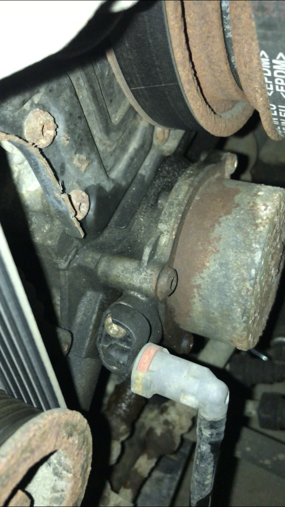

after hearing a noise from a pulley while idling I popped the hood to take a look, unfortunately what I found was the start of an oil leak. Just changed my oil maybe 3-4 weeks ago and it wasn’t there. It appears to be coming from a weird engine mounted accessory or.....the timing chain cover( I’m assuming that’s what the black metal plate is) anyone ever seen a leak in this location before or know what part it could be? Leak is contained to just that area. (Drips down onto that hose, hose has no leak) View attachment 9032View attachment 9033
My vacuum pump seems to be leaking too. I noticed it when I was changing out my alternator a couple weeks ago. Let me know how your swap goes. Looks pretty straightforward.

will do, weather is going to be crap here in Georgia Friday through Monday so im going to head back home to Florida(where all my tools are) im assuming you have to drain the engine oil to remove the pump. does anyone know for sure? ive only got 1k on this oil change and hate to waste $80 bucks in oil.
Didnt think about that! Just did an oil change too. I’m guessing no drain necessary, but would have a clean pan below in case...but if you have a mightyvac, you could evacuate and just refill once done.
