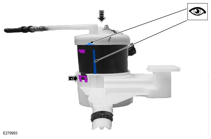

Parts required for the recall.
Fuel tank flange assemblyLR1127851
Fuel filterLR1751721
BracketLR1133381
Fuel tank flange O-ringLR1174761
Hose clipCN1005
New fuel filter:
