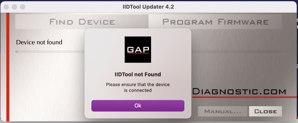

    Hello,
    I have received two IIDTool BTs already (From Lucky8 and GAP) and when I try to update them, I get the same error. "IIDTool not Found Please ensure that the device is connected".
    -I have tried two Macs (Catalina and BigSur) and one PC (Windows 10) already.
    -3 different USB cables.
    -2 IIDTools.
    I don't think any of the computers are detecting the IIDTool!
    Does anyone have any advice for me? I feel pretty stuck as the GAP Support (All email. No one to call directly), hasn't been able to figure out the issue. I can't program a key as the IIDTool needs to be updated.
    Thanks!

    I had this error. Ended up being a faulty tool. Had it replaced and the replacement worked fine.
    Weird it would happen 2x in a row to you

    I hope that's not the case because I just ordered one from Lucky8's Black Friday Sale ($428 total w/free shipping!). I won't have it for a few days, but I'll post how it goes. You've probably considered this, but perhaps security on you Mac or security software may be blocking the device connection...maybe need to authorize it? Thanks for posting..hope you can get it working..Let us know.

    I never used to believe that cables could “go bad” but it’s happened enough times that I start suspecting them if basic methods don’t fix an issue. Good luck.

    At this point, I take any suggestion. Thank you! In Mac under privacy -> Accessibility, it's not coming up. Also, I don't see it poping up under Security & Privacy -> General -> Allow apps downloaded

    Agreed. GAP is telling me that they have shipping +10K to customers and they hardly see any issue but that's a general statement and I don't have any data in hand! I might be the lucky one with two faulty devices. Also, in the manufacturing of semiconductor, we don't consider our testing good if we don't have about +500K data points :) Maybe electronics are different. I will ask GAP if they test USB connectivity before shipping every unit out.
    It could be my problem but it seems odd as I have tried 2 Mac machines and one Windows. It shouldn't be this difficult to update the device. They both work fine connecting the rig and my iPhone. I just can't update the firmware via the USB connection.
