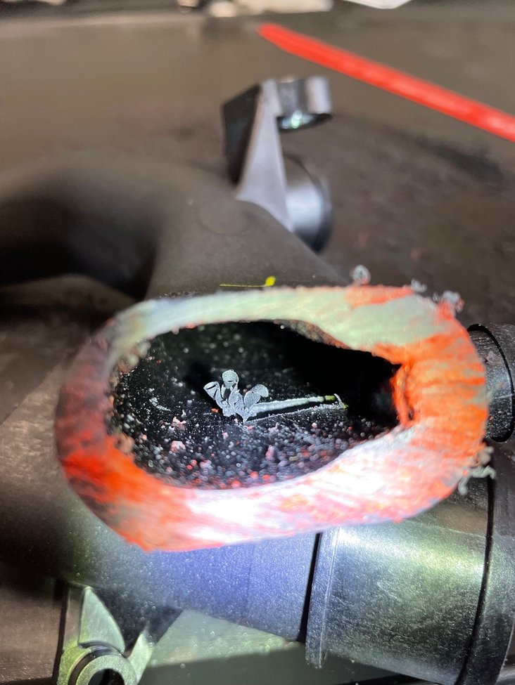

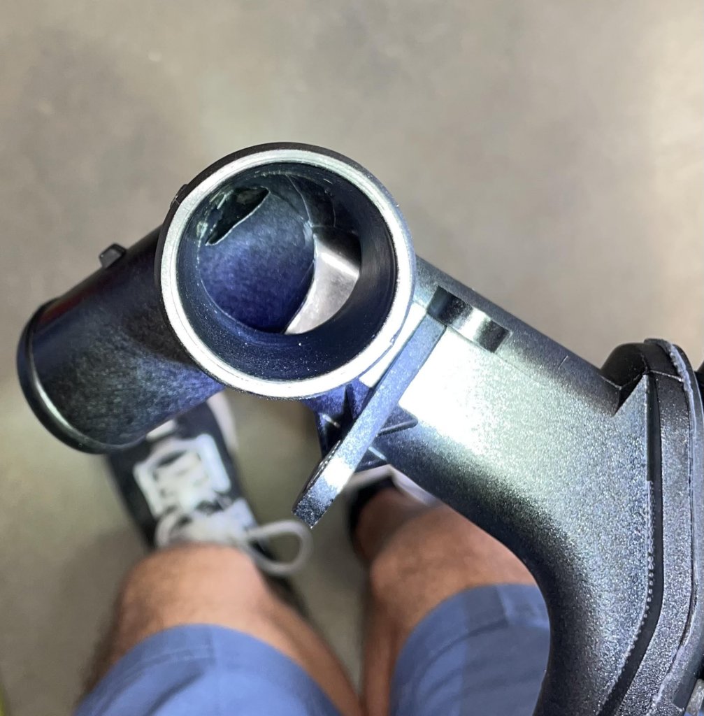

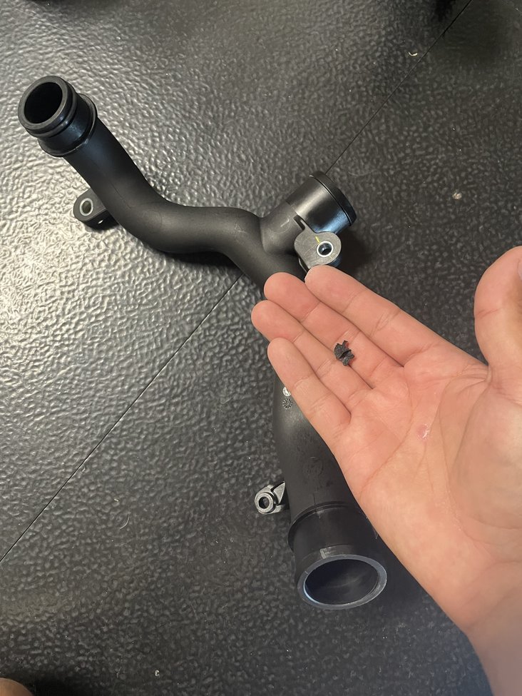

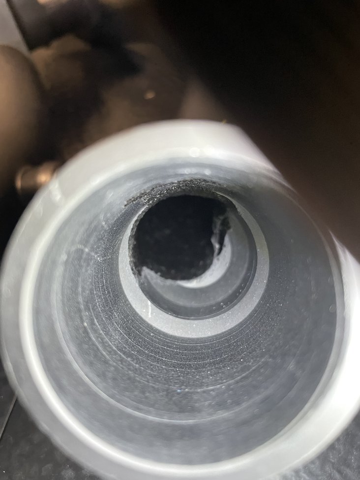

As I replied a couple years ago about failing plastic crossovers with my suggestion reply that "if I owned one" ( I like my improved trouble free 4.9 pushrod engine). I would of fabricated a jig along with having a donor 5.0 engine to work off, Tig welded crossovers front and rear out of aluminum ending those on going plastic failure issues.
How great is that to rely on plastic way out in the bush beyond any tow service, call the U.S. Army and have the LR Helicopter lifted out?
