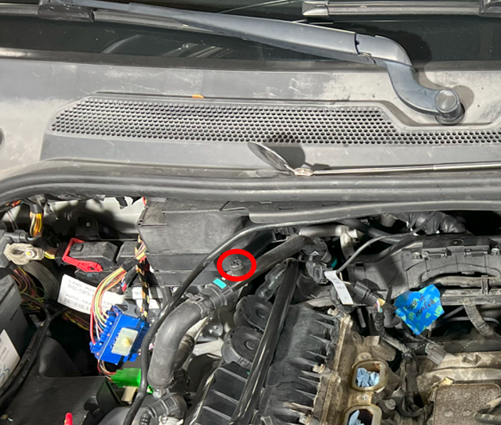

If you don't have a vacuum filler, if memory serves, I believe there's a bleeder valve in the return hose...right near the battery...ish? (Sorry, it's been a hot minute since I've looked at it, and both of my LR4's are not here right now.)

You're correct; there's a bleeder as indicated here:

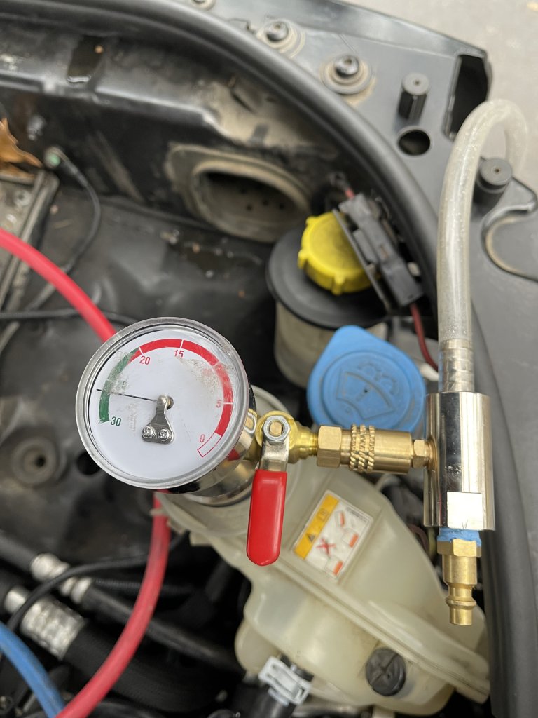

As for the vacuum fill process, it's REALLY easy. Full disclosure, I bought the AIR LIFT kit off FCP Euro...wasn't the cheapest, but it's very effective! Plus I used parts and a few extras I bought to switch it from vacuum to pressure so I can pressure check as well). Anyway, you simply fit the little rubber grommet and gauge into the reservoir tighten the collar to expand the rubber grommet for a good seal, then hook up you air hose and open the valve. It should pull roughly -27ish psi (or was it inches Hg) anyway, then just let it sit for 30-60 minutes to make sure you've got a good seal in the system, then swap the vacuum tube for the "fill tube" and then open the valve and it'll suck the coolant into every crevice the system!
