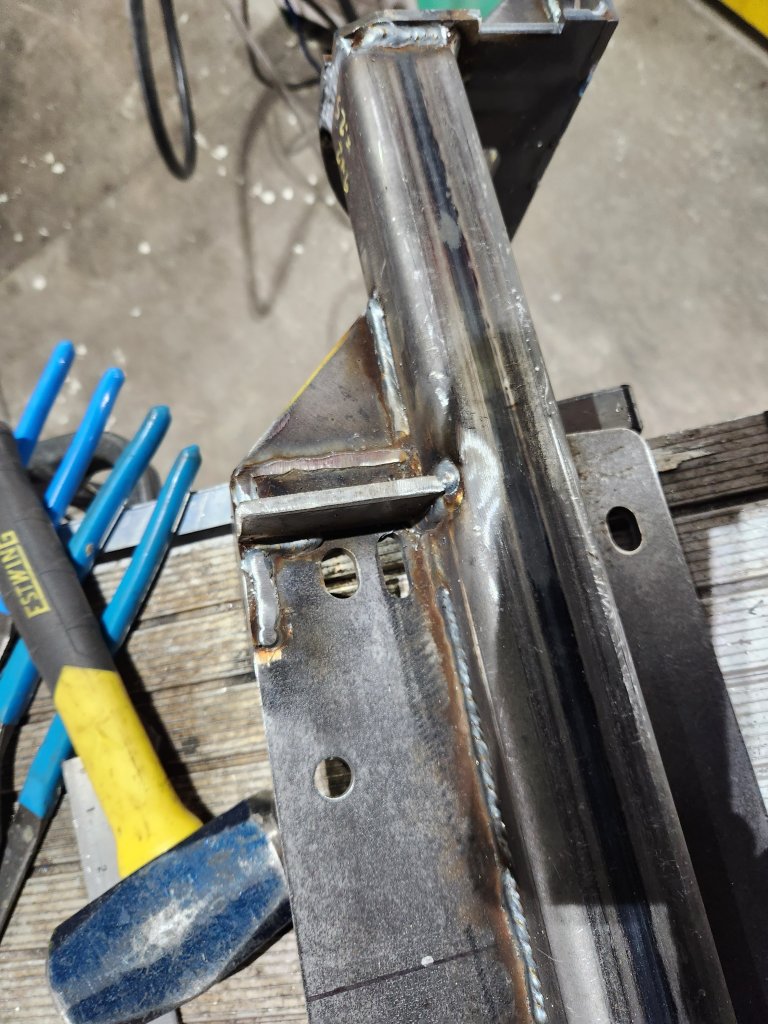

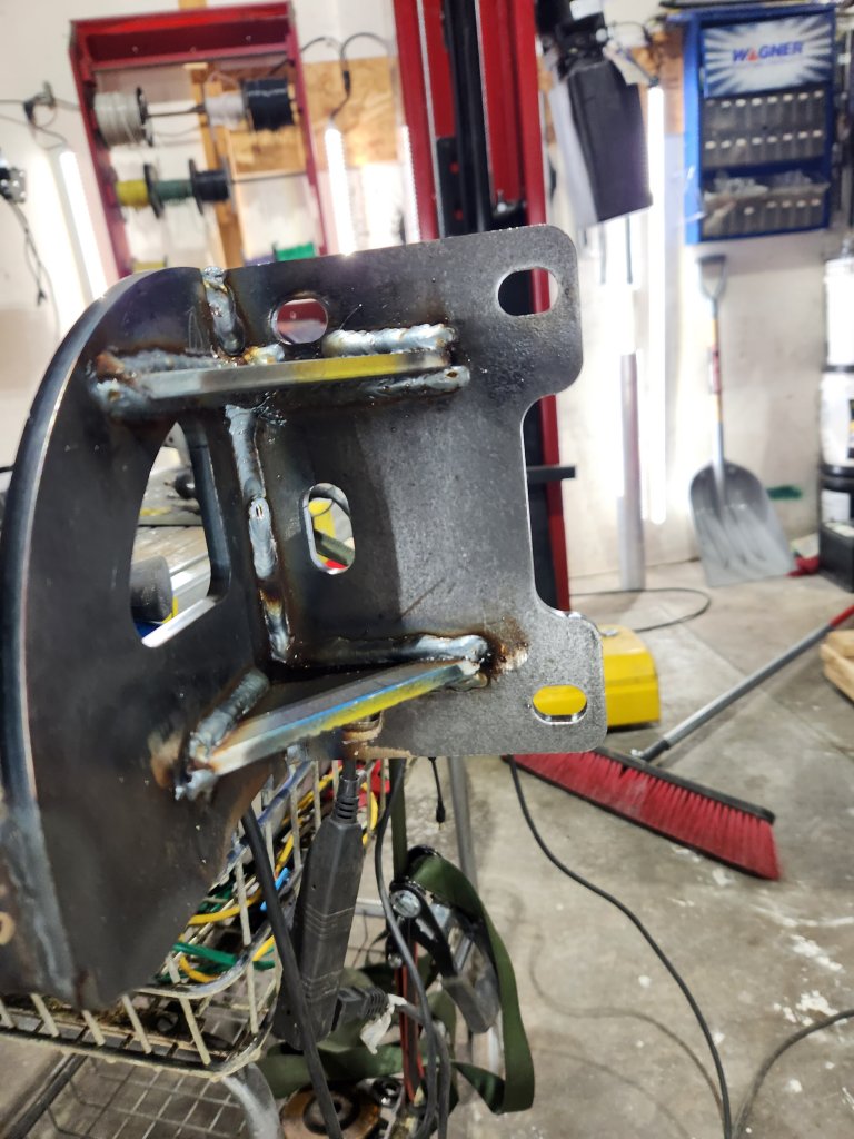

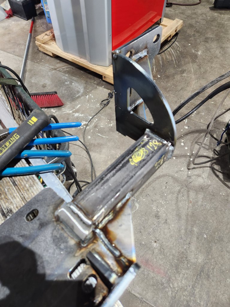

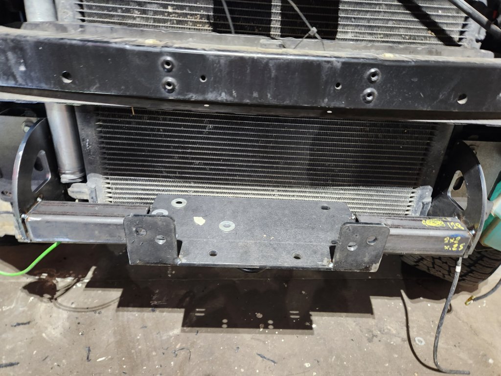

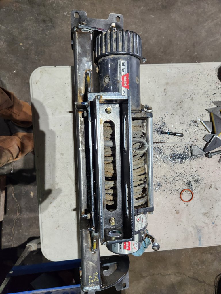

Since I keep running into issues trying to get my new engine, I figured I would start assembling my hidden winch mount. It is based off of the winch plate by LRTime.
I have added a few modifications. I will post up the final product when it is installed. This install is super tight with the 2014 plus models that have an intercooler in the way. Many winch plates dont account for this or give you spacers to get around this. The tube had to be notched to lower the winch plate. The winch plate also had to be moved forward.
