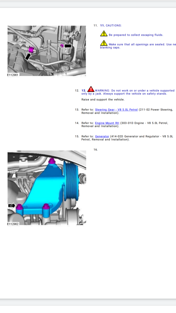

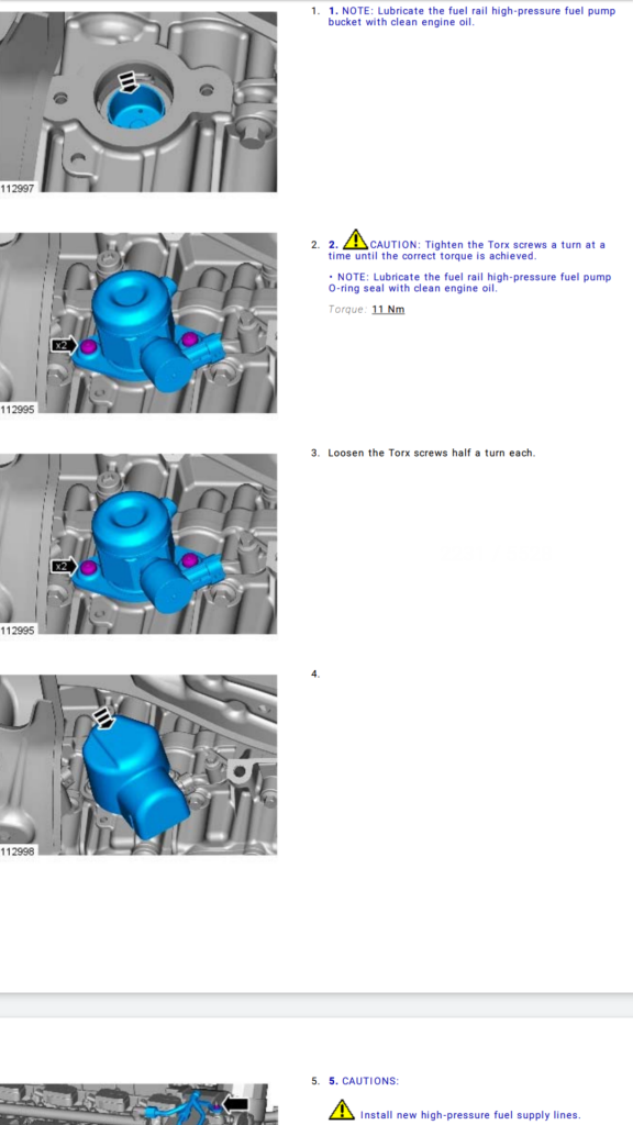

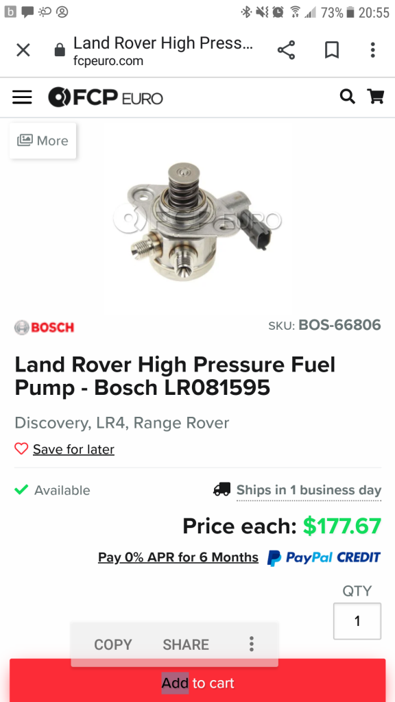

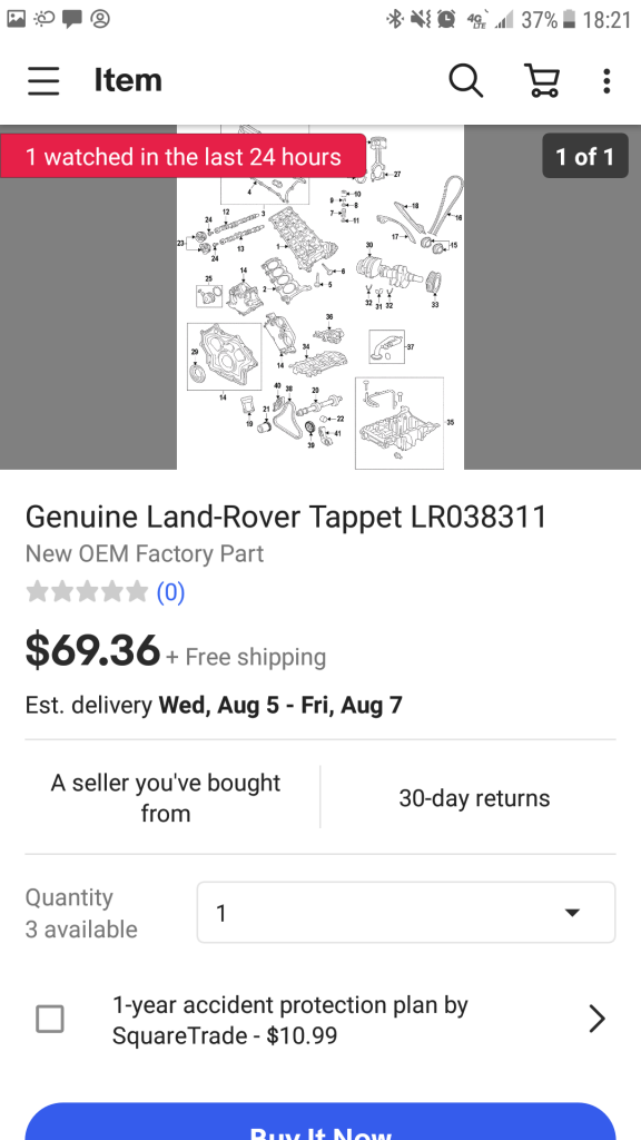

    There are two. Was actually researching this last night. You'll want the tappets too and the service manual states to replace the high pressure fuel line when swapping out the pumps.
    Screenshot_20200728-205507.png Screenshot_20200729-182050.png Screenshot_20200729-182107.png

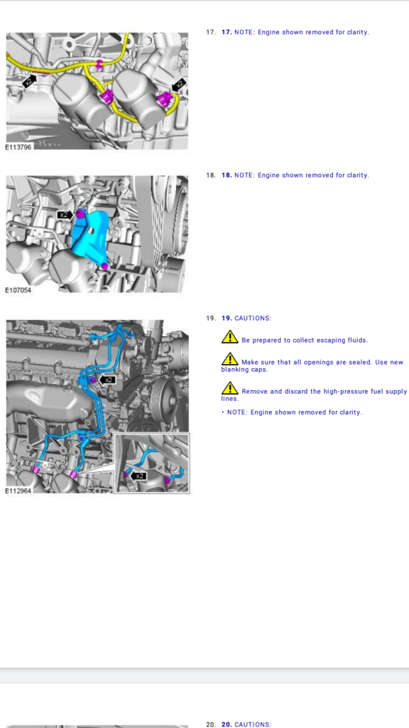

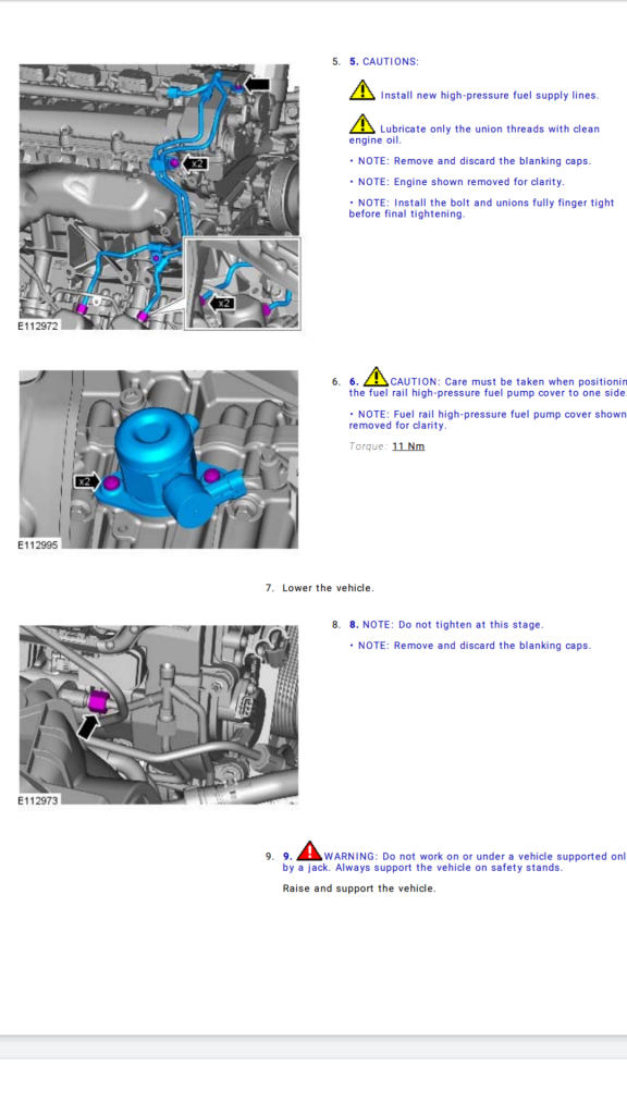

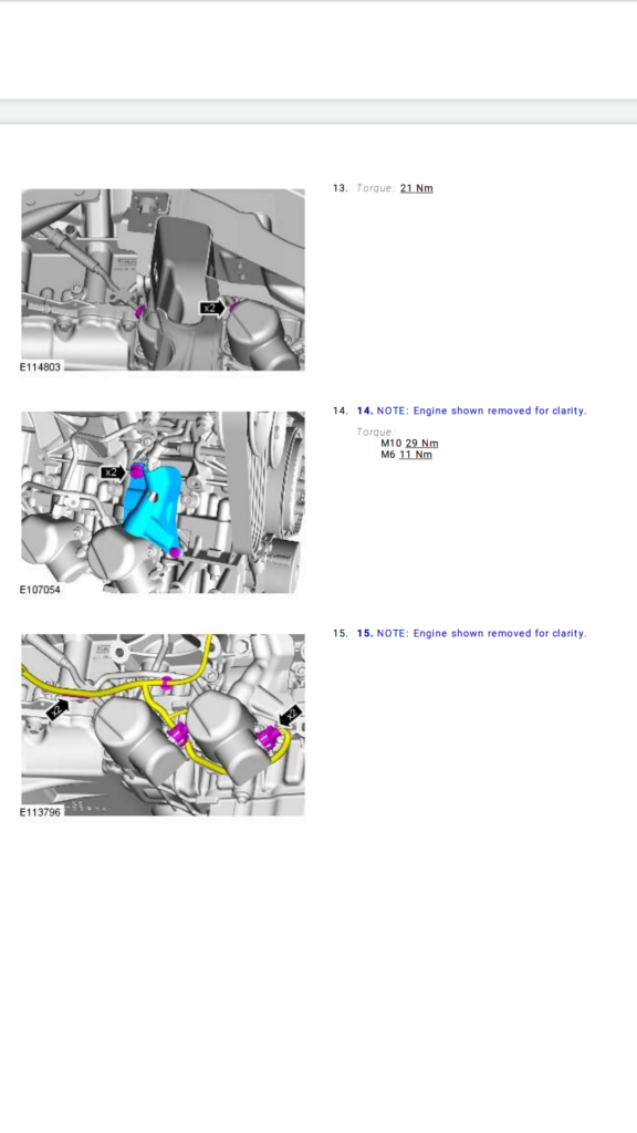

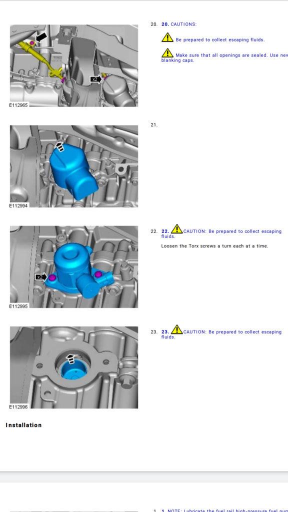

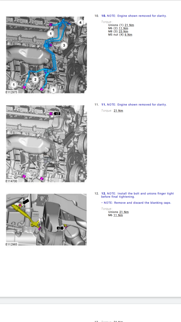

    Any time. Here are the sections in the service manual to help you plan.

  6. djkaosone
    djkaosone '11 LR4 HSE LUX 5.0L V8
    Posts:
    389
    Likes Received:
    248
    Joined:
    Oct 26, 2015
    Location:
    SoCal
    I've done this. I would highly recommend depressurizing the fuel lines at the top fuel rail junction first, then proceed with the manual. You'll also want full face protection and not just eye protection from catching the escaping fuel.
    I didn't use a lift, just set it to the highest setting and rolled under it. I simply removed the sump skid and plastic side to get to it. In hind sight, if you remove the wheel well it's completely open for easy access. Also try to slide the black foam sound dampeners/covers as far away as possible or it'll be forever soaked from catching escaping fuel, like mine. Overall, it's an easy job. If I remember correctly the union fittings are 17mm.
    Good luck.
