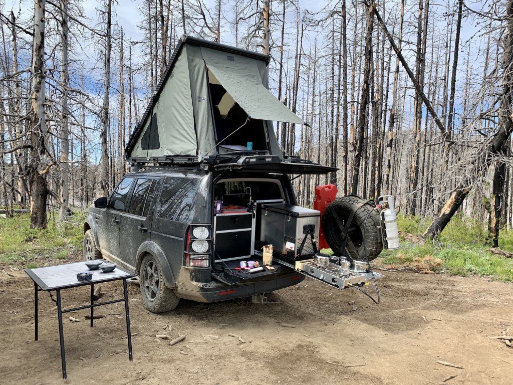

    Goose Gear make some of the highest quality drawer systems. They don't yet have a dedicated baseplate for the LR4 (I have heard one is in the works though), but their generic plate fits with only a few minor modifications. Their camp kitchen is an awesome way to hold a stove and fridge. IMG_4918 2.jpg

    which rear spare tire carrier are you using? any thoughts on quality?

    It's a Voyager Racks carrier. It's odd... half of it is well designed and half of it is poorly designed. The good: The pivot is extremely solid with two thrust bearings used in the design which is great. I also love the latch they use - it's a lot more subtle and OEM-feeling than most of the big lever latches I see on swing-arms and carriers. Overall, it can support a lot of weight. The bad: The installation is a joke; Voyager send you a couple of JPGs with no scale that you're supposed to print and somehow hope they line up. The bolts that come with the carrier to mount it to the vehicle are coarse-threaded machine bolts. The whole gas strut assembly is terrible - the strut they supply has flat tabs with holes on each end that are supposed to be bolted to the carrier and vehicle - there's no bearing on any moving surface, and the mount point on the arm is just a welded nut. Also, regardless of what Voyager tell you, it will cause havoc with the blind spot monitoring fitted to 2014+ vehicles. They also place a locating hump on the plate where the wheel bolts (presumably to locate a wheel in a hub-centric fashion? it's too small in diameter though), which prevents you from using a lot of spare wheel style accessories like bike racks or jerry can holders. And lastly, the three studs used to mount the wheel were not welded square to the frame, which meant that when I bolted a rim up, it gorged the inside of the rim - when I spoke with Voyager about it, they told to "bash them with a 2x4".
    Having said all this, I wasn't able to find much else on the market. Front Runner used to make one, but I couldn't locate it in the US, and it's not as subtle or integrated as the Voyager one. I've already made a few improvements to the Voyager, and will replace the gas strut with one that uses ball-joints on either end so it has a proper bearing surface.

    thank you so much for the detailed description. i plan to order a voyager low profile rack for a RTT along with their sliders, ladder, rear receiver, and likely their hidden winch mount and front skid plate.
    i had planned on the rear swing away as well, but have been second guessing when weighing positives and negatives of it. my other option is building out a rear storage setup and storing the spare inside the car which is where i am leaning.
