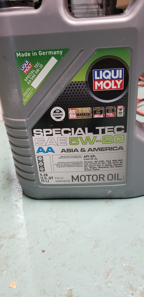

I have a 2010 with 90k miles on it owned for 3yrs. Initially I used the stupidly priced Castrol edge pro, but do not trust the extended interval. Plus the price must compensate for fewer dealer oil changes right?
Now I use luiquimoly which supposedly meets spec. Change twice a year every 6k miles or so.
Use German Mann filters.
I don't really trust any anecdotal engine oil recommendations personally, as engine wear incremental, so your average owner is not going to ever appreciate whether their oil is better or worse than any other. Frequent changes much more important IMO. I am in Canada too!!
