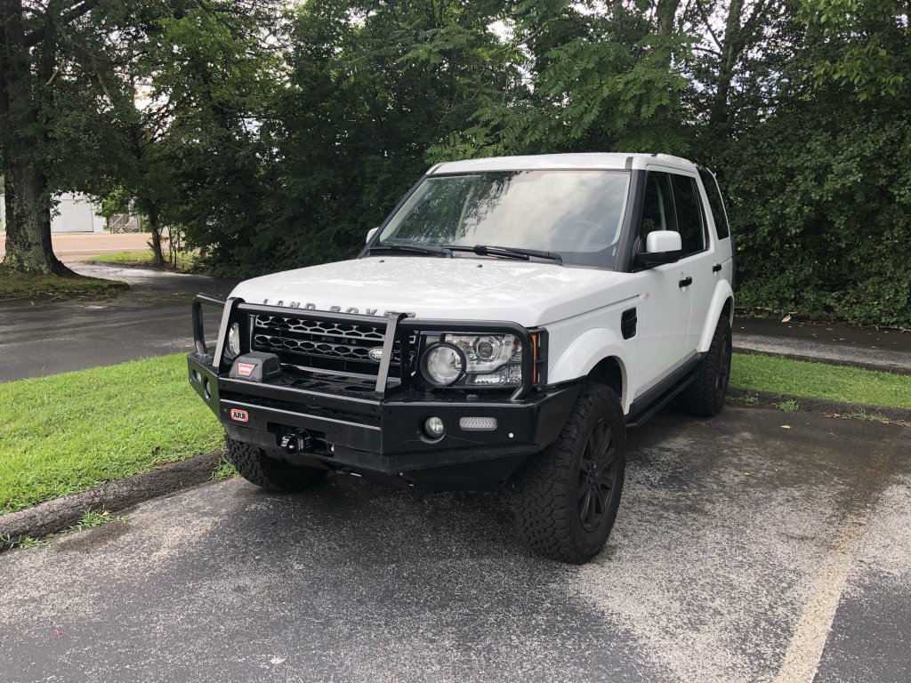

Picture of my Rover because I can. It’s running LR3 18” rims with spacers, BFG AT in 265/65R18s which requires some trimming to clear at full lock (~31.5”).
